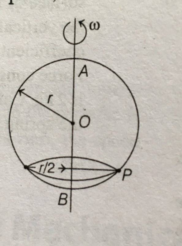

A smooth wire of length ##2 \pi r## is bent into a circle and kept in a vertical plane. A bead can slide smoothly on the wire. When the circle is rotating with angular speed ##\omega## about the vertical diamteter ##AB##, as shown in figure, the bead is at rest with respect to the circular ring at position P as shown. Find the value of ##\omega ^2##..

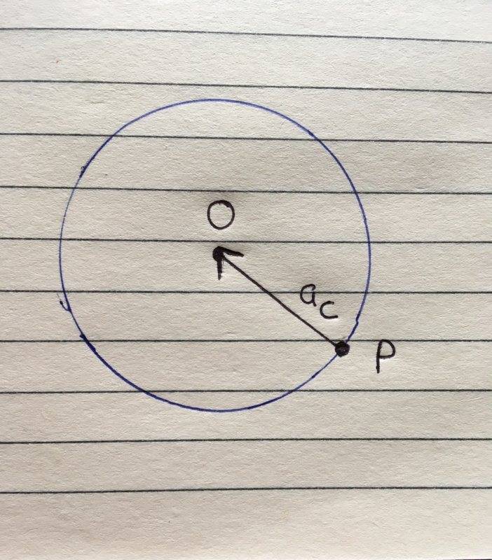

I attempted to solve it this way: at point P there is gravitational acceleration ##a_g = - g ~\hat{j}##. Now, I thought for point P to be in static situation (w.r.t. to the circle) this downward acceleration must be cancelled.
But if centripetal acceleration’s direction of point P were to act horizontally from point towards AB then we won’t get ##a_g## cancelled. How about having a centripetal acceleration acting from P to the point O? In this way we surely going to get a vertical component of centripetal acceleration.

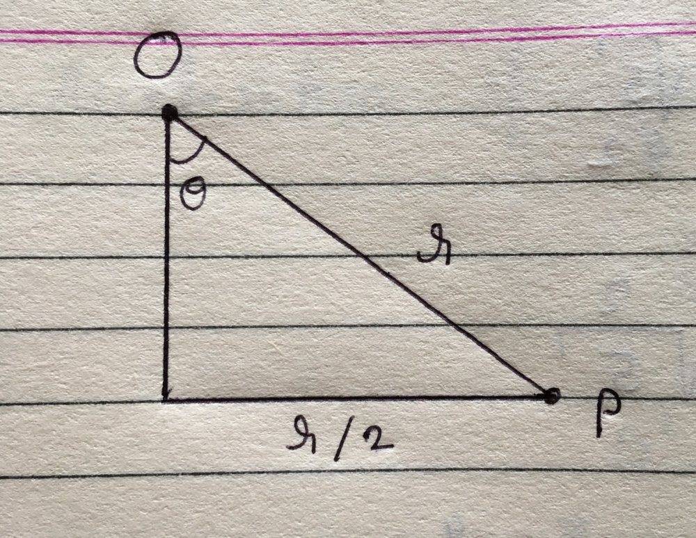

By some simple geometry:
We would get ## \theta = \frac{\pi}{6}##. Now, the vertical component of ##a_c## is ##a_c \cos \theta = \frac{v^2}{r} \frac{\sqrt 3}{2} = \frac{\sqrt 3 \omega^2 ~r}{2} ##. Now for equilibrium we must have $$ a_c \cos \theta = g \\
\frac{\sqrt 3~\omega^2 ~r}{2 } =g \\
\omega ^2 = \frac{2g}{\sqrt 3~r}$$.
Although, I have reached to the correct answer but I suspect the step when I said the centripetal acceleration would act from P towards O.
You're forgetting the normal force from the wire. For equilibrium the combined force of gravity and the normal force must equal the required centripetal force.

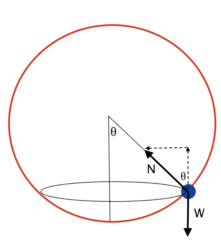

Whether the wire is spinning or not, there are two forces acting on the bead. If there were only gravity, then the bead would fall straight to the ground (as though the wire were not there). As the bead falls, the wire forces it to move in the shape of the wire. As there is no friction, this force must be normal to the curve of the wire.
There is no direct centripetal force in this problem. In equilibrium, the centripetal force is the sum of the other two forces: it's the total force in ##F = ma##.
Adesh said:
Normal force from what? Can you please draw it in my diagram which I have posted in my original post?
If you can tolerate my crude artistic skills, this is a cross-section of the bead and wire frame, where the blue part is supposed to be the wire frame and the black part the bead. The red arrows are the contact forces.
For any angle other than ##\theta = 0## the normal force is going to have a horizontal component because the plane of contact between the wire and the bead will also no longer be horizontal wrt the lab.
Does normal force act towards the Center and when we resolve it the vertical component cancels the gravity and the horizontal component causes it to move along the curve of the wire?
If that is so, then how do we find the magnitude of the normal force ? And how the wire exerts the normal force, is it the two portions of wire on the sides P exert forces on it?

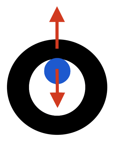

I think the blue part represents the bead and the black represents the wire.
The wire is a circle and the normal to a circle is colinear with the radius.
You find the forces the way you always do in an equilibrium problem: balancing forces using ##\vec F = m \vec a##.

I’m still getting two problems:
1. From the diagram of @etotheipi (that blue ball and black rim diagram, where he made the mistake of calling the blue ball as the wire instead of the bead 😂) it was quite natural to imagine that normal force existed, but in real life the wire goes through the bead (there is a hole in the bead through which the wire goes) and I’m finding it very hard to imagine how normal force will be exerted in that case.
An unfortunate mistake on my part :eek:
See post #5. Sorry for the colour change!
