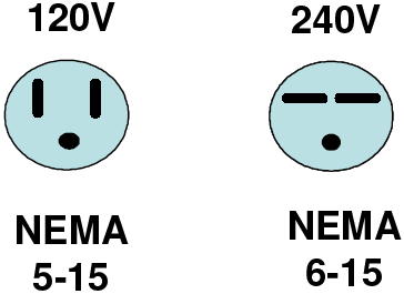

There are some 240V, 60Hz outlets in homes in the US, for things like large appliances (clothes dryers, etc.). They use a different plug, so you may be able to find a plug adapter to go from the 240V house outlet to your adapter's power plug. Does the adapter list any frequency limitations?
These are the typical US outlets for 120V and 240V:
http://www.heatersplus.com/images/heattr16.gif
