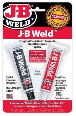

Hi
I need to glue steel with G10 material together. But it is in moving parts environment that constantly see oil for the moving parts. My first thought was epoxy, but can it survive in oily environment in the long term. Any other suggestions?
thanks
Alan
JB weld
Likes yungman and dlgoff

Ranger Mike said:
yes
i am very familiar with two part JB Weld in IC engine applications. never has failed me.
Sealing up and filing space..not good to hold a broken connecting rod.
Just to verify, this is the one. I actually have it at home.
Thanks

It's mostly room temp. It's something I carry in my pocket only.
OK, this is really what I am using it for. It's for a pocket folding knife.
The knife has G10 scales( outer cover), inside is steel liner on both sides of the blade. The G10 scales are screwed together with the steel liners on the pivot screw and a few screws on the handle. The G10 help to stiffen the handle against prying. I made a mistake of thinning out the area around the pivot area of the G10, so it's so thin that it's not good enough to stiffen the handle up.
What I am trying to do is to glue the G10 scales close to the pivot area to the steel lines so they become one piece to be stronger. The thing is I need to oil the pivot as the blade has to flip open and close.
It's going to be in my pocket when I go out, that's it. It's not any deep science, just I want to beef up the knife.
If the KB epoxy I showed is good enough for the purpose, that it can survive in oily environment, that's all I need.
Thanks
Yes this is the stuff...i use it on engine blocks for race cars. Water passage block. has never leaked or failed with many years heating and cooling. can be drilled but tapping not recommended. You can surround a threaded insert and it will hold in moderate applications. EVERY crew chief I know has this in the pit box.
Likes yungman
