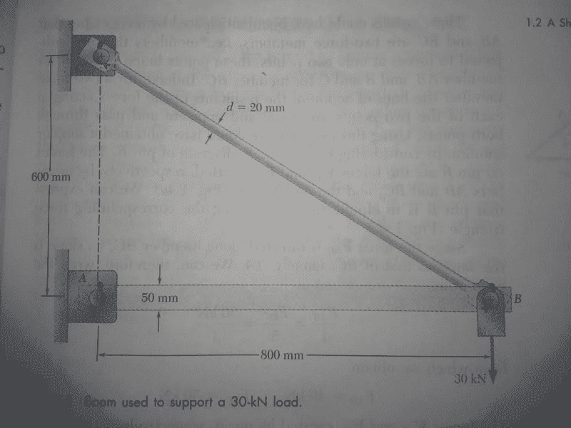

I signed up for Mechanics of Materials, but it turns out my statics is very rusty. Here is the problem, we are to compute the six component forces about the joints:
Force and moment equations are the name of the game.
[/B]
My problem arises thusly:
I sum the moment about A. I place: C_x(.6)+(B_y).8=0. We know from the diagram that b_yu = 30. Simply solve this equation, and the result is C_x = 40. This is correct, according to the book.
Now, I go to sum the moments about B, C_x(.6)+A_y(.8)=0. This yeilds A_y =30. According to the book A_u=0. What is invalid about my approach?
Thanks a ton.
Your equation assumes C_y is zero.
Chet
