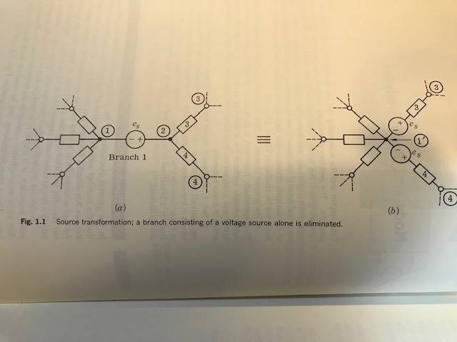

In the text " The Art of Electronics" by Horowitz and Hill there is little formal network theory and need for solving large systems of equations. They believe that their approach gives a better understanding of the choices and compromises that engineers face in circuit design.
The authors develop models for active devices as BJTs and FETs. They avoid what they call unnecessary pedagogical approaches not used by practicing engineers. They look at circuit design as more of an art using a combination of basic laws, rules of thumbs, and a large bag of tricks. They do not get lost in math.
Check it out.

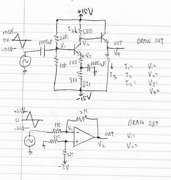

My interview questions for analog design were always very simple schematics with "canonical" behavior. Like step response of an LC tank with Q=∞. I'll draw a current mirror, you explain it. Frequency response of a dominant pole compensated op-amp (integrator, or amp, whatever). Draw a flyback DC-DC converter and explain how it works. etc.
If they really understand the basics, then I want to know about the more complex stuff that they have knowledge of, a school project or such. If you don't know the simple stuff, I won't teach it. But if you do know that stuff, and you've shown me that you did sometime else worthwhile, then I'll probably assume that you can teach yourself the details you need. After all, no one would come in already knowing exactly what they'll be doing in the future.
BTW, it was astounding to me how many EEs can't deal with the step response of an LC circuit. There isn't a physics student out there that can't describe the motion of a weight hanging on a spring when you pull it down and let it go, yet most EEs can't do the same with the circuit version. Then sometimes you get a ringer, that just writes down the whole answer, frequency, amplitude, characteristic impedance and all, because they've used it before.
I gave very simple test. But you'd be surprised how many people failed.
Just very simple question like these. fill out the DC voltages and currents, then draw the output waveform respect to the given input waveform.
If anyone needs KVL, there's the door. Of cause, they can use calculator.

I think today, it's the job seeker's market, they let you pass with simple questions. I was applying for jobs in 2002, the deepest of depression in hightech. You better believe I got test on Smith Charts impedance matching on the spot. What is KVL?
  • #33
Joshy said:
Quite honestly I think you'd be pointing me to the door and I'd probably be fine with that, but I'm curious why you're so against KVL or why it wouldn't work well? I think it would. I personally would not be discouraging recent grads from using it in interviews; I'd actually encourage it and would prefer if my coworkers could solve problems using the fundamentals.
Ha ha, I hope if you work on my two questions in post 25, you don't ask me about what's the beta of the transistors and doing KVL. I would hope you would ask me to lower the 20K and 10K voltage divider resistors to get better consistence.
These are REAL circuits in projects, not some made up stuffs.
  • #34
Well I might be one you'd show the door too. And knowing what I know, I wouldn't be sorry about it. I'd likely ask the beta to determine if it's necessary to improve the voltage divider bias as you describe. Your management style would attract fly by the seat of their pants type folks in my opinion. Lowering the voltage divider resistance also draws more power. Would you show me the door if I asked if this circuit went into a product that is powered by battery? Concerned about battery life and all. You want an engineer who is actually able to make the best set of compromises or one that simply gives you answers that make you feel good?
Likes Tom.G and Joshy
  • #35
If you only carry a hammer in your toolbox. every problem will look like a nail. The expert carpenter carries a panoply of tools, and works to become better with each of them..
Likes Averagesupernova and Joshy
