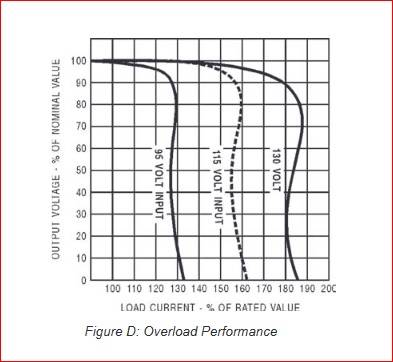

Since i have no idea what your machine does
but i have spent a lot of time studying inrush current characteristics of instrumentation loads in the power plant
and studying overload characteristics of power supplies, DC to AC inverters , fuses ,circuit breakers and the like
it seems natural to me somebody might use your machine for such testing to assure he is about to build a "well co-ordinated*" instrument power system.
*(Co-ordination has a specific meaning , see
http://www.tnbpowersolutions.com/sites/default/files/webfm/resources/upload/Cyberex%20Data%20Center/ABB%20Breakers%20and%20Panelboards/Breaker%20Coordination%20WP.pdf )
I'd want to know how your machine behaves with overloads particularly brief ones like one-half to five cycles duration.
How much current into a dead short ? Voltage droop ?

Ability to set its droop or sag would be a plus If that's something it can do. . Here's shape of a typical ferroresonant inverter's droop
as you see it's not linear like a transformer. I call it "Flimsy" or "Weak" compared to the stout transformer behind a wall socket.old jim
