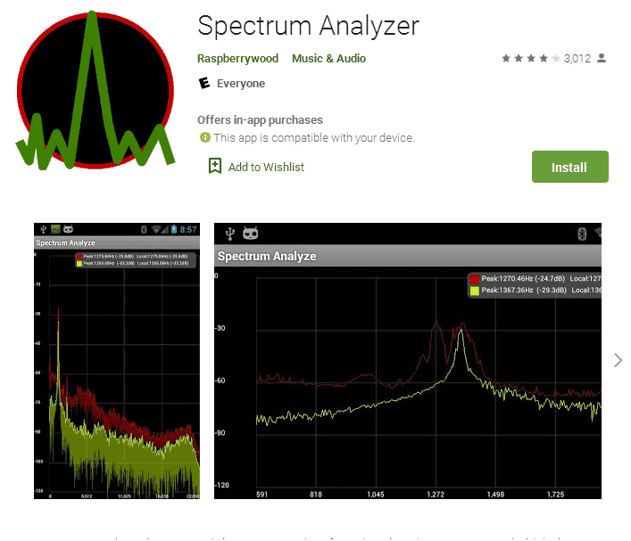

One way to figure this out would be to download a free audio spectrum analyzer to your smartphone, and play those tones either live or with a recording. Here is one such app that appeared first on my Google search list:
https://play.google.com/store/apps/details?id=com.raspw.SpectrumAnalyze&hl=en_US&gl=US
If you prefer the peaks in percentages, just use the dB readings and convert them. It's pretty easy math, and you could just put the formulas into an Excel spreadsheet to make it more convenient to do repetitively.
