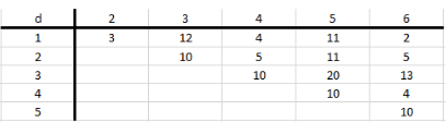

We are given the input for TSP with $6$ points with the following distances:
I want to find the approximation for a TSP-Tour using the NEAREST NEIGHBOR and the NEAREST INSERTION by starting by the vertex $1$.

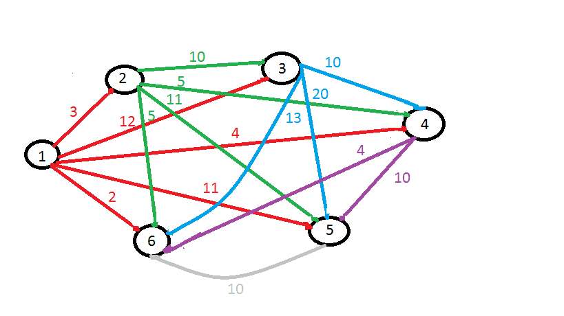

Do we have the following graph from the above table?
Or do we get a directed graph? (Wondering)
