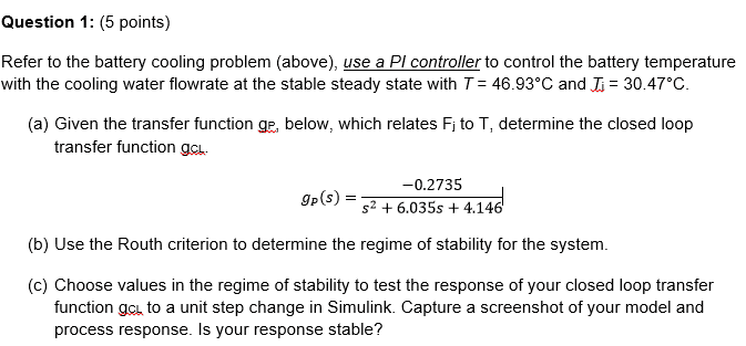

What are the Closed Loop Transfer Function Parameters for a PI Controller?
In summary, the conversation is discussing the transfer function of a PI controller and the closed-loop transfer function. There is some confusion about the correct form of the PI controller, but it is eventually determined that the given expression is valid. The conversation also touches on using the Routh–Hurwitz stability criterion to find suitable values for the controller parameters.
gfd43tg
950
50
I don't think you need to see the problem to figure this one out, if needed I will post it (takes up a lot of space in the thread).
I know for a PI controller, the controller transfer function is given
$$ g_{c} = k_{c} \frac {\tau_{I}s+1}{\tau_{I}s} $$
and the closed loop transfer function is given
$$ g_{CL} = \frac {g_{p} {g_{c}}}{1+g_{p}g_{c}} $$
So I multiply,
$$ g_{CL} = \frac { (\frac {-0.2735}{s^{2}+6.035s+4.146}) (k_{c} \frac {\tau_{I}s+1}{\tau_{I}s}) }{1 + (\frac {-0.2735}{s^{2}+6.035s+4.146}) (k_{c} \frac {\tau_{I}s+1}{\tau_{I}s})} $$
However, I don't know what ##k_{c}## or ##\tau_{I}## are, so I am wondering if there is some what I should know these? Then I can have a numerical answer for part (a).

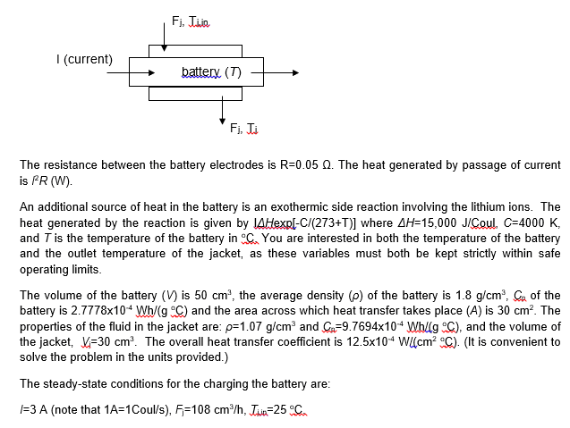

Please post the full problem so we know the feedback configuration.
The task in (b) is to find suitable values for those controller parameters using the Routh–Hurwitz stability criterion.
Just leave them as variables for now and reduce the closed-loop transfer function down to a form where the numerator and denominator polynomials have simple coefficients.

I'm glad everyone is learning from my homework problem. So I simplified my expression in my OP to
$$ g_{CL} = \frac {-0.2735k_{c}(\tau_{I}s+1)}{\tau_{I}s^{3}+6.035 \tau_{I}s^{2} + (4.146 \tau_{I} - 0.2735k_{c} \tau_{I})s - 0.2735 k_{c}} $$
So my characteristic equation is
$$ \tau_{I}s^{3}+6.035 \tau_{I}s^{2} + (4.146 \tau_{I} - 0.2735k_{c} \tau_{I})s - 0.2735 k_{c} $$
The first necessary criteria is that all coefficients are positive, therefore ##\tau_{I} > 0##, and ##4.146 \tau_{I} - 0.2735k_{c}\tau_{I} > 0##, and ##-0.2735k_{c} > 0##.
This is weird, so it means ##k_{c} < 0##, and from the second coefficient, ##k_{c} > 15.159##, so it doesn't give a proper range of values for ##k_{c}##, I was expecting something like ## a < k_{c} < b##

Okay, here is my routh array
$$ \begin{bmatrix} \tau_{I} & 4.146\tau_{I}-0.2735k_{c} \tau_{I} & 0 \\ 6.035 \tau_{I} & -0.2735 k_{c} & 0 \\ 4.146 \tau_{I} + (0.045 - 0.274 \tau_{I})k_{c} & 0 \\ -0.2735k_{c} \end{bmatrix} $$
since I know ##k_{c}## is negative, then ##0.274\tau_{I}-0.045 < 0##, therefore ##\tau_{I} < 0.164##
So I know the range for the time constant is ##0 < \tau_{I} < 0.164##
I suppose ##0.274 \tau_{I} - 0.045## is negative, so I divide and get
##k_{c} > \frac {4.146 \tau_{I}}{0.274 \tau_{I} - 0.045} ##
so my gain range is ##\frac {4.146 \tau_{I}}{0.274 \tau_{I} - 0.045} < k_{c} < 0##

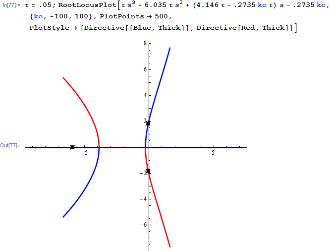

That's not how you do it, using root locus:
1. Plot the root locus.
Now, look at the curve. If there are problems problems, you can move/add poles and zeroes that twist the path of the curve. A pole will repel the path, a zero will attrack the path. It's like planning a slalom track by placing red and blue marks:
Having moved/added poles/zeroes, just redraw the plot: Is it satisfactory? Maybe this zero should be moved a little more to the left ( e.g. dragging it graphically with your mouse )?
With a little training, you can systematically drag 8 poles and 8 zeroes in turns and redraw/inspect the result.
As I said: You can do it in 5 minutes ( well, maybe in 10 minutes as for 8 poles/zeroes ).
2. I don't have to record tables. It's more convenient just to look at the root locus plot.
The stable area is to the left of the imaginary axis as for the s-plane.

Maybe this will make it easier to show you my point:
Try, from your root-locus analysis, to arrive at the same result as the OP.
It's interesting to look at root locus plots for the cases where τ < .164 and τ > .164, varying kc from -100 to +100:
