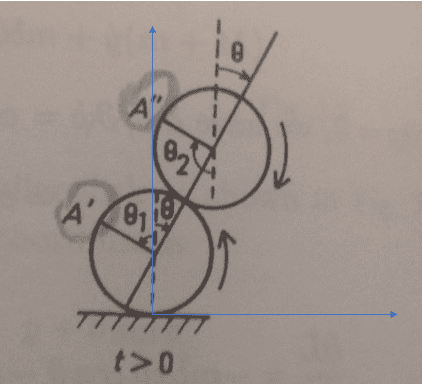

I was solving a problem and got stuck in two aspects:
1) Geometric issue.
Alright, I understand that the coordinates of the lower cylinder are
$$( -R \theta_1, R)$$
The coordinates of the upper cylinder are:
$$( x_1 + 2R \sin \theta, 3R - 2(R-\cos \theta))$$
I get that the ##x## coordinate of the upper cylinder is ##x_2 = x_1 + 2R \sin \theta##
But I do not understand why ##y_2 = 3R - 2(R-\cos \theta)##.
2) Algebraic issue
I have the following two equations:
$$\frac 1 2 M R^2 \Big( 3 \dot \theta_1^2 + 2 \dot \theta_1 \dot \theta(1 - 2 \cos \theta) + 6 \dot \theta^2 \Big) + 2MR(1 + \cos \theta)g = 4MRg \ \ \ \ (1)$$
$$MR^2 \Big(3 \dot \theta_1 + \dot \theta ( 1 - 2 \cos \theta) \Big)=0 \ \ \ \ (2)$$
There has to be a way to combine them such that we eliminate ##\theta_1## to get:
$$\dot \theta^2 \Big( 18 - (1 - 2 \cos \theta)^2 \Big) = \frac 12 R (1 -\cos \theta) g$$
But I do not see it. What I have done is multiply the second equation by ##-\frac{\dot \theta_1}{2}## and then add both up. Like that I just get rid of the first terms of both equations.
Could you please give me some hints on 1) and 2) issues?
Thanks.

You really need to give more details and give the context for this problem.
It looks like it might be posted in the wrong forum. You have derivatives (Calculus) here, and perhaps kinematics relevant to a physics course.
As far as I can tell:
  1. You have two cylinders (each of radius, R) in contact.
  2. When you refer to the coordinates of a cylinder, you mean the coordinates of the center (axis).
  3. θ is the angle that the line joining the centers makes with the vertical (measured clockwise?). At time, t=0, θ=0.
  4. θ1 is amount of rotation (counter-clockwise) made by the lower cylinder.
  5. θ2 is amount of rotation (clockwise) made by the upper cylinder.
Does the lower cylinder slip with respect to the horizontal surface and/or the upper cylinder?
What are A' and A'' ?
Likes JD_PM

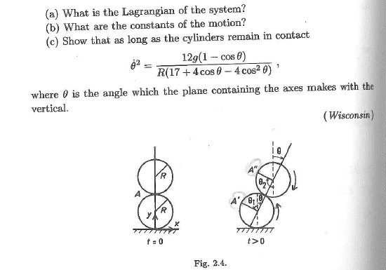

Alright, the whole problem is:
Is Calculus Forum the best option? I will report the question.
Both cylinders roll without slipping.

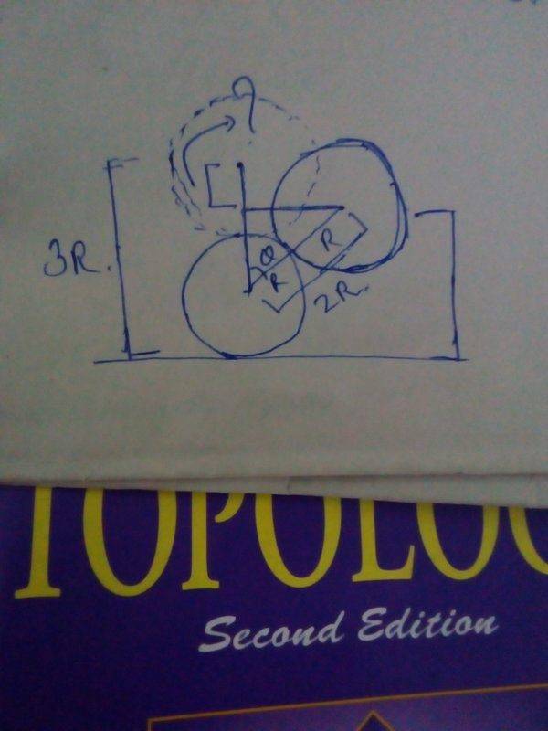

Your Geometrical issue has typing mistake. Instead of ##3R-2(R-cos\theta)##, it should be ##3R-2R(1-cos\theta)## as can be seen from geometry as well as dimensions.

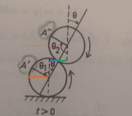

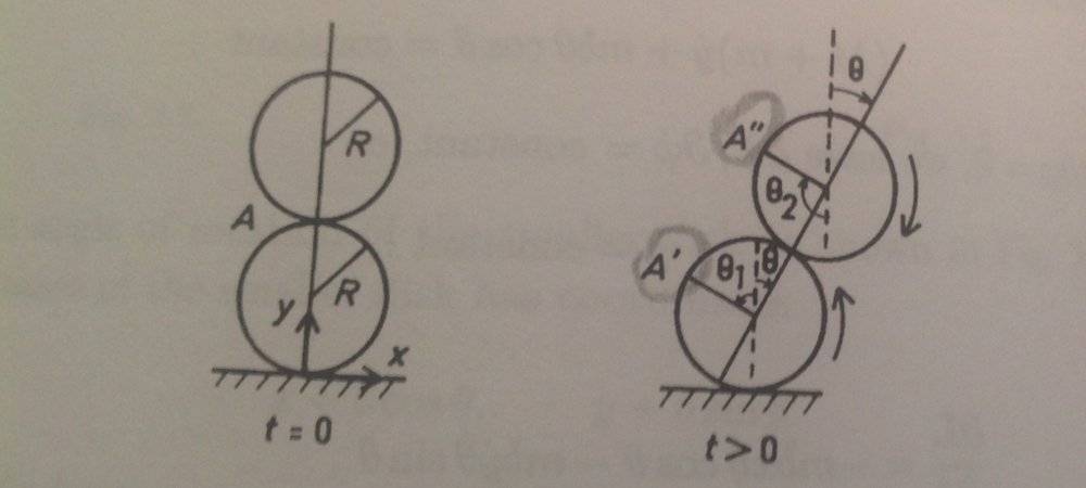

Let me show what method I am using to determine the coordinates of the lower and upper cylinder.
The ##(x,y)## coordinates are taken as follows (##x## horizontal and ##y## vertical):
Coordinates for the lower cylinder
x coordinate
By straightforward geometry we get:
$$\sin \theta_1 = -\frac{x_1}{R}$$
Applying the small angle approximation ##\sin \theta_1 \simeq \theta_1## and solving for ##x_1## we get the desired result:
$$x_1 = -R \theta_1$$
y coordinate
The blue line is the radius ##R##. We get the desired result:
$$y_1 = R$$Coordinates for the upper cylinder
x coordinate

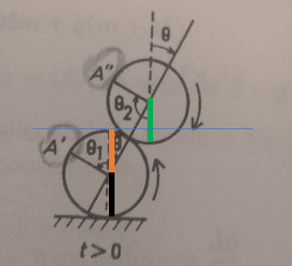

OK. The method is to obtain an equation for the orange, blue and green pieces and then add them up to obtain an equation for the thin red line.
- Orange slab
We already know an equation for it; ##x_1 = -R \theta_1##
- Blue and green slabs.
Both have the same mathematical expression: ##\sin \theta = \frac{x'}{R} \rightarrow x' = R \sin \theta##
Thus the mathematical expression for both is ##2 R \sin \theta##
Adding the mathematical expressions of the orange, blue and green slabs lead to the desired result (as expected):
$$x_2 = x_1 + 2 R \sin \theta$$
(Note: in the provided solution the small angle approximation is not applied to ##\theta## but it is applied to ##\theta_1##; why?).y coordinate (the one I am stuck in)
I wanted to use the latter method to get the desired result
$$y_2 = 3R-2R(1-cos\theta)$$
But it seems that it is not a good idea. For this method to work we would need the blue line not to cross the green slab. How can I proceed then? Should I switch method?
Any help is appreciated.
Thanks.

There is no need to use the small angle approximation.
If the lower cylinder rotates through angle θ1, then any point on the circumference moves a distance ##R \cdot \theta_1## along the circumference of the cylinder. The cylinder moves without slipping on the horizontal surface. Therefore, the cylinder moves a distance, ##R \cdot \theta_1## in the negative ##x## direction.

As said, the given formula is wrong. The picture will be really helpful to you. Alternatively (which is how I actually got y-coordinate) , we have R distance from ground to centre of 1st sphere. Then there is 2Rcos##\theta## so that total distance is R+2Rcos##\theta##
Likes JD_PM and SammyS
Your picture was really helpful, thanks.
