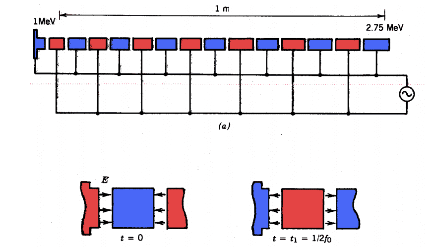

The second type of Linac, used for ions, is the made by a lots of cavities connected to an alternating potential source as sketched below:
(http://web.mit.edu/course/22/22.09/ClassHandouts/Charged Particle Accel/CHAP14.PDF pag 453)
Here, each cavity is an equipotential surface so no E field is inside. The ion is accelerated only in gaps between cavities and the whole structure support a standing wave (not a propagating wave as in the first case). I see no waveguide here, but probably the whole structure could be enclosed in a cylindrical conductor (thus forming a waveguide)... I don't know.
Is what I said correct ? Because I am really confused. If I keep reading those document I run into Traveling wave Linac and Standing wave Linac, but I don't understand if they are referring to what I already said or if there are other types of Linac which I am neglecting... I am pretty confused right now.
It seems to me that you've got the basic right.
I think a better and more accessible resource than those MIT handouts is the lecture notes from the major accelerator schools, e.g. the CERN Accelerator School (CAS) or the Joint Universities Accelerator School (JUAS). In [1,2] you have the lectures from JUAS on linacs. The names traveling wave and standing wave are pretty descriptive of what's going on, but the linked lecture slides gives a very nice overview of the different kinds. Also contains nicer pictures! (The MIT handout you linked is woeful, in my opinion).
