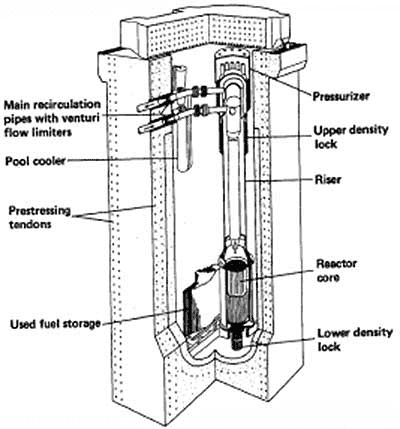

I have to put a plug in for my own former employer's (ASEA ATOM) design the PIUS reactor. It was intended to do what reactors are best at --- making hot water, not electricity. The hot water would have been used to provide district heating for the city of Helsinki. Yes, a reactor sited at the downtown of a major city. But alas, the press conference to announce the Helsinki project was preceded by the news from Chernobyl by 24 hours. Today it is even hard to find references to PIUS on the Internet.
http://www.i-sis.org.uk/CloseUpOnNuclearSafety.php
The PIUS design goal was “complete protection against core melting or overheating in case of any credible equipment failure, natural events such as earthquakes and tornadoes, reasonably credible operator mistakes, and combination of all those. In addition, the design should protect against inside sabotage by plant personnel completely knowledgeable about reactor design, terrorist attacks in collaboration with insiders, military attack, as by aircraft with ‘off-the-shelf’ non nuclear weapons, and abandonment of the plant by the operating personnel.
Such a PIUS light-water reactor was indeed designed by ASEA-Atom that would cost no more than a conventional plant with the same generation capacity. But to-date no PIUS plant has been ordered.
https://www.euronuclear.org/e-news/e-news-17/nps-kth.htm
Likes bhobba and DEvens
Wow, had no idea you worked on PIUS. Good on you!
The design always struck me as elegant, particularly the passive safety features .
Unfortunate indeed that the Helsinki deployment was prevented, it could have done a lot to bring the nuclear debate back to the real world.
Likes bhobba and anorlunda
