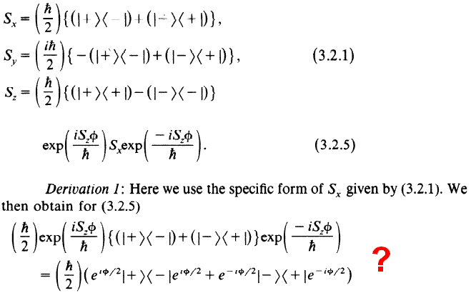

Hi folks,
The attachment is from Sakurai where he's getting started on angular momentum. I don't understand how he gets between the two equations I stuck a ? on. Any hints gratefully appreciated.
Adrian.
Hi Adrian! :smile:
It's ordinary algebra …
A(pq + rs)B = ApqB + ArsB,
together with Sz|+> = |+>, Sz|-> = -|->, and the expansion definition of exp :wink:
