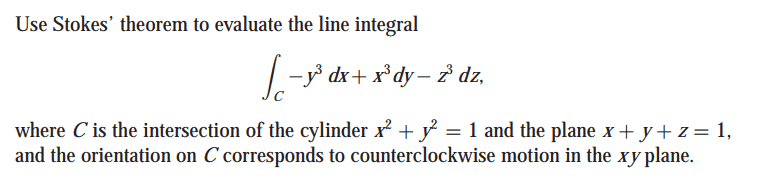

I want to compute:
$$\oint_{c} F \cdot dr$$
I have done the following:
$$\iint_{R} (\nabla \times v) \cdot n \frac{dxdy}{|n \cdot k|} = \iint (9z-1) dxdy$$
I don't know what limits the surface integral will have. Actually, I am not sure what's the surface.
May you shed some light?
Thanks

After some thought I came to a different result of ##\int (\nabla \times \vec F) \cdot da##:
$$\nabla \times \vec F = (2z - 1) \hat{i} + 3 \hat{j}$$
$$\vec n = 3 \hat{i} + \hat{j} + \hat{k}$$
$$\hat{n} = \frac{3 \hat{i} + \hat{j} + \hat{k}}{\sqrt{11}}$$
As Orodruin pointed out, ##\int (\nabla \times \vec F) \cdot da## depends only on the boundary line, so we can pick out whatever surface we want (in our favour of course). Let's pick the circle as the surface:
Using polar coordinates we get:
##\int (\nabla \times \vec F) \cdot da = \int_{s} 6z ds = \int_{0}^{2\pi} \int_{0}^{3} 6r(1-3rcos\theta - rsin\theta) drd\theta = 54\pi##
How do you see it?

After some thought I saw that the projection of the enclosed surface on the ##xy## plane is the given ellipse. So we indeed need to get a unit normal vector of that ellipse:
$$n = \nabla (\frac{(x-2)^2}{4} + (y-1)^2) = \frac{x-2}{2} \hat{i} + 2(y-1) \hat{j}$$
$$\hat{n} = \frac{\frac{x-2}{2} \hat{i} + 2(y-1) \hat{j}}{\sqrt{\frac{(x-2)^2}{4}+ 4(y-1)^2}}$$
I guess there has to be a way of simplifying ##\hat{n}## but don't see it :(
So now we just have to set up the integral:
$$\iint (\nabla \times \vec F) \cdot d \vec a = \iint[(2z - 1)\hat{i} + 3z\hat{j}][\frac{\frac{x-2}{2}\hat{i} + 2(y-1)\hat{j}}{\sqrt{\frac{(x-2)^2}{4}+ 4(y-1)^2}}]da$$
Now we got to make a change of variables so as to go from an ellipse to a circle centred at the origin.
Rearranging the curve we get:
$$\frac{(x-2)^2}{36} + \frac{(y-1)^2}{9} = 1$$
Using the following change of variables and using it:
$$x - 2 = 6u$$
$$y - 1 = 3v$$
$$u^2 + v^2 = 1$$
Don't forget the Jacobian! :)
$$\frac{\partial(x, y)}{\partial (u, v)} = 18$$
$$-18\iint[(36u+6v+13)\hat{i} + (36u+9v+12)\hat{j}][\frac{\frac{6u}{2}\hat{i} + 2(3v)\hat{j}}{\sqrt{\frac{(6u)^2}{4}+ 4(3v)^2}}]dudv$$
There's just one step left: apply the last change of variables (polar coordinates):
$$u = rcos\theta$$
$$v = rsin\theta$$
Before doing that please let me know of your thoughts on what I've done at this point. (I am really having a good time with this problem btw xD)

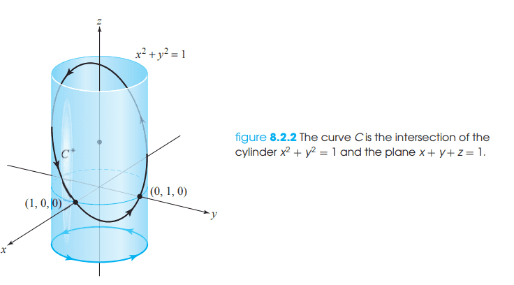

Mmm,I think I misunderstood the problem. Actually I thought that we had this situation (example coming from Marsden):
But instead of ##C## being the intersection of the shown cylinder and the shown plane we got ##C## being the intersection of the elliptic cylinder ##\frac{(x-2)^2}{36} + \frac{(y-1)^2}{9} = 1## and the plane ##3x + y + z = 1##.
If I am not mistaken, your point is that ##C## is not the intersection curve but the elliptic cylinder ##\frac{(x-2)^2}{36} + \frac{(y-1)^2}{9} = 1## itself, right?
No. A curve cannot be a surface so this is definitely not my point. There is no projecting the curve on the ##xy## plane, there is parametrising the surface using the ##x## and ##y## coordinates.

You have a plane that cuts through a cylinder. The cylinder cuts it in the curve ##C##, giving an elliptical shaped portion of the plane. That elliptical shaped portion of the plane is the obvious choice of a surface ##S## bounded by the curve. It is true you could use some other surface with the elliptical curve as its boundary but it would be challenging to find such a surface simpler than a plane. So, to reiterate, the surface is a piece of a plane and that is what you want the normal to.
Now, all you have left is to work out ##\iint_R -27x - 9y + 6~dydx## where ##R## is the interior of your given ellipse which I will write $$
