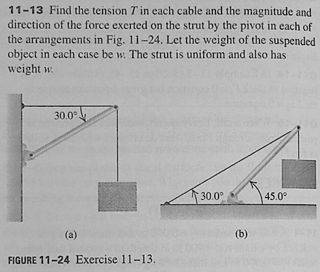

I'm not sure of that. I should have attached a photo of the original problem - let me do that now. I am just working on part (a) for now:

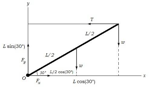

Here is another way to work the problem. Consider the following free body diagram:
The tension in the vertical cable is obviously $w$. So let's find the tension in the horizontal cable.
To begin, let's sum up the torques about the origin:
$$\tau_O=0$$
$$TL\sin\left(30^{\circ} \right)-w\left(\frac{L}{2}\cos\left(30^{\circ} \right) \right)-w\left(L\cos\left(30^{\circ} \right) \right)=0$$
Combine like terms and divide through by $L$:
$$T\sin\left(30^{\circ} \right)-\frac{3w}{2}\cos\left(30^{\circ} \right)=0$$
Solve for $T$:
$$T=\frac{3w}{2}\cot\left(30^{\circ} \right)=\frac{3\sqrt{3}}{2}w$$
Now, we see by equilibrium, we must have:
$$F_y=2w$$
$$F_x=T=\frac{3\sqrt{3}}{2}w$$
Hence the magnitude $|F|$ and direction $\theta$ of the force exerted on the strut by the pivot can be found as follows:
$$|F|=\sqrt{F_x^2+F_y^2}=\frac{\sqrt{43}}{2}w$$
$$\theta=\tan^{-1}\left(\frac{F_y}{F_x} \right)=\tan^{-1}\left(\frac{4}{3\sqrt{3}} \right)\approx37.589089469^{\circ}$$
https://www.physicsforums.com/attachments/1306
The tension in the vertical cable is obviously $w$. So let's find the tention in the horizontal cable.
$$\tau_O=0$$
Solve for $T$:
$$F_y=2w$$
Hmm.. I think the question asks us to consider the horizontal and vertical strings(or cables) as different and not same.. just as you did. I, in my solution, had assume that its the same string. In that case, no solution exists as the torque about the origin is not coming out to be zero. So its worth mentioning that if a single string is used then the strut cannot maintain an angle of $30^\circ$ wrt the horizontal.
Ackbach said:
My problem: I cannot find another equation. There are 4 unknowns, and only 3 equations. I tried applying the torque version to another point on the strut (the existing equation was exerted at the pivot), but that does not provide another independent equation.
Perhaps needless to say by now, but your 4th equation is:
$$F_{c} \sin( \varphi) = w$$

Very nice! I see that you have not assumed the tension is the same everywhere in the cable. Do you happen to know under what conditions a cable of negligible mass would have equal tension throughout its length? I know, for example, that on at Atwood's Machine, if the pulley itself has significant mass, then the tensions on either side of the pulley can be different, but if the pulley has negligible mass, then the tensions are the same.
Ah, but does the cable have to have the same tension throughout? That's sort of the question I'm getting at in my response to MarkFL's solution.
So, Newton's Second Law applied to the hanging mass provides the final equation. Very nice!
It appears you already know the answer. :)
What is slightly confusing in your problem is whether the cable is attached to the strut, or whether it can slide or roll freely.
Realistically, from the given set up, it has to be attached, but it would be nice if that were given.
Otherwise, the tension would be the same everywhere in the cable.
If that were the case, either you need an extra torque where the strut is attached to the wall, or the whole things would come collapsing down.
I actually assumed the cable was attached to the end of the strut so that we could treat the cable as two separate sections. :D
