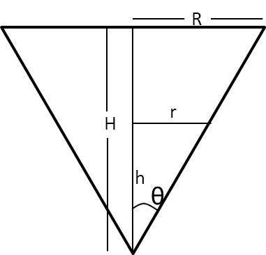

I've tried these problems but I just can't wrap my head around them. Thanks to anyone that can help me out here. I have a couple more problems similar to these to solve, but if I can get to understand these then I'll have no problem with the others.
Here are some diagrams I drew: http://gyazo.com/bf78da97179aa8d62d5e44b484ffcdc3 and http://gyazo.com/65689d4a0de1f23ceeae3c236c1c891e
1. Homework Statement :
A conical paper cup is 30cm tall with a radius of 10cm. The cup is being filled with water a rate of 16*pi/3 cm^3/sec. How fast is the water level rising when the water level is 6cm?
dV/dt = 16*pi/3
r=10
h=30
hw(height of water)=6
dh/dt=?
2. Homework Equations :
V=1/3*pi*r^2*h
3. The Attempt at a Solution :
V=1/3*pi*r^2h
dV/dt=1/3*pi*r^2*dh/dt
16*pi/3=1/3*pi*10^2*dh/dt
3/100*pi *16*pi/3=100*pi/3dh/dt *3/100*pi
16*pi/100*pi=dh/dt
16/100=dh/dt
