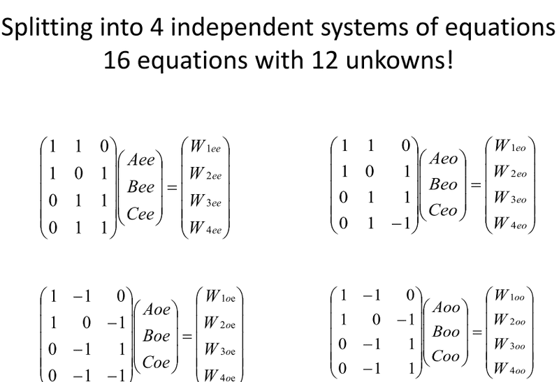

Hi chiro,
thank you very much for your reply. Yes I am using the Moore-Penrose pseudo-inverse. Actually the original problem can be seen in the attached picture. After using the pseudo-inverses it is stated that only the first three systems have a solution, but that there is too little information to solve for A00, B00 and C00. When I am multiplying with the pseudo-inverses I get the unitary matrix on the left hand side, but for the last system. So I wondered how that is related to the last one not having a solution and what the reasoning is. I thought about independence, but there is also row-degeneracy in the matrix of the first system.
I hope that this still makes sense. Any idea?

I'm wondering just as a curiosity, whether you have tried using a least squares approach to get some kind of reference for your solutions?
hmm..what do you mean by that least square approach? I just wanted to check a solution, I just don't understand the mathematical reason why the last system cannot be solved for A00, B00 and C00.
How would you go about the least square approach though?
Thank you very much. I think I spotted the problem with the matrix, as for square-matrices the Moore-Penrose inverse needs independent vectors, but unfortunately there is two dependent column vectors. At first sight I just spotted degenerate row vectors, but of course there has to be dependent ones with a 4x3.
