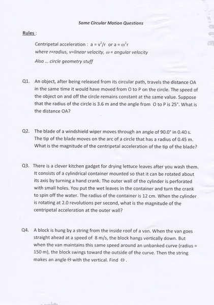

issh
Centripetal Acceleration: a=v2/r or a=w2r
where a= Centripetal Acceleration
v= Linear Velocity
r= Radius
w=angular velocity
Question Number 1: Drew a diagram of a circular with one point being O, another being P and another being A, Radius of Circle is 3.6m, and joined O and P to a 25o
MIGHT BE WRONG
Question Number 2:
Turn of 90o takes 0.4 seconds
Therefore 90degree/0.4 seconds = 225 degrees per second or
Therefore using equation
a=w2r
a=2252*0.45
a=22781.25degrees/sec
Pretty sure this is also wrong as for acceleration, it seems too fast
Question Number 3:
Drew diagram--> Circle[Radius 12 cm][2 Revolutions per second]
a=w2r
Question Number 4:
Honestly have no idea how to start
For 1, since the speed on and off the circular path remains constant, then the distanced traveled in an equal amount of time is identical. This means OA = OP. What remains is to calculate OP which can be done using simple circle geometry.
For 2 and 3, you look to be on the right track.
For 4, consider the block's motion. Since the car follows a circle of radius 150m at a speed of 8m/s the block must do the same. The string is the thing accelerating the block, so the angle will be such that the tension offers the suitable amount of centripetal acceleration.
Thanks Yuqing
For question 1, pretty sure its correct!
Due to fact speed of object is identical(from OP to OA), and also same time, therefore DistanceOA = Distance OP
Find circumference of circle then find length of 25degree
Therefore
C(25degree)= 2*pi*3.6*(25/360)
C(25degree)=1.57m
Thanks
now for Q2-4!
