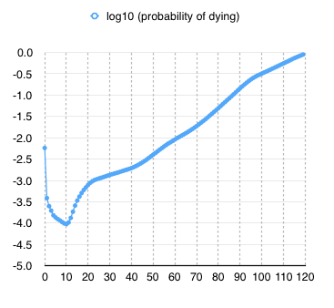

Is there a name for it when the probability of dying is linear(ish) when plotted on a log scale?
At least, when ignoring the bathtub part, that is.
Coincidentally, back in August, I downloaded the file that @FactChecker referenced yesterday. Mostly in an effort to get a better understanding of all the deaths of old people during our pandemic. Hence, my ready made graphic(s).

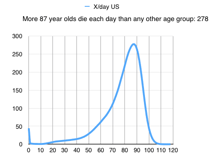

One of the graphs I made back in August prompted me to ask myself the question: "How do they define life expectancy?"
If 87 is the most popular age to die, then that should be how we define life expectancy, right?
It wouldn't be until yesterday that I put in the effort to figure it out.
I would explain how it's done, but it's too complicated at this time of the morning.
Anyways, the reason I bring this up, is that at age 118, my maths gets a bit buggy, and says that you should have died last year.
Not sure I've ever seen maths be rude before.
Likes Dale
There are two definitions of life expectancy -- the cohort and the period life expectancy. Both are means, which is an average. The most popular age to die is the mode, not the mean. The difference is that if a small number of people live a very long time, they change the mean but not the mode.
