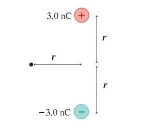

What are the strength and direction of the electric field at the position indicated by the dot in the figure
Figure has been attached with the thread
E = kq/r^2
