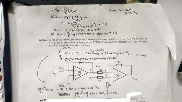

Hello,
I am trying to Calculate The Resistance Rf and the value of the Voltage V2. The setup is a logarithmic Op amp connected to a differential Op amp. Both Op amps obey the Golden Rules.
Attached below is my attempt at the solution and the question.
Currently, I have an equation with three variables, and so i think i need potentially two more equations but do not know how to obtain these.
Any help would be appreciated

Perhaps you could provide a closeup image of the circuit diagram oriented in the correct way?
Edit: Also type out the problem statement. The text is all but unreadable in your image.

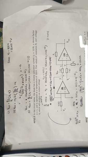

I'll try rotating it and enhancing the contrast a bit...

The text says
' In the Circuit below, the diode has a reverse saturation current Is= 10fA, a device factor n=1 and is operated at a temperature of 300K . Find values of resistance Rf and voltage V2 which will produce an output voltage.
Vout = ln (Vin)'
