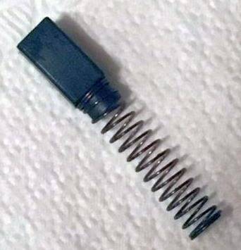

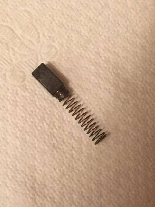

I disassembled the motor and cleaned it The brushes are half used up. The commutator was black with carbon which I removed using lapping film. I didn't think to check for roundness. I'll do that next with calipers. I don't have a way to check for offset relative to the bearings. The motor brush link is cool. Thanks!
Even new springs on these are pretty wimpy. Oily carbon deposits can easily prevent the brushes from sliding forward as they wear. I did notice that the curved part off the brushes that meet the commutator are offset as if the brushes are sitting crooked. If so it probably gets worse as the brush gets shorter. The commutators on these sewing motors don't have many sections. I wonder if that's why you sometimes have to help the machine get going by giving the hand wheel a spin. I even see this on old films of people sewing with this same machine. I'll add some pictures of the motor parts when I get a chance.
It varies from motor design to motor design, but if by this you mean the brushes are half their original length, then they may already be at 100% wear out, particularly if the brush features a "shunt" (a piece of braided wire embedded into the carbon). This is done so there's no chance the shunt will carve into the commutator when the brush is totally worn out.

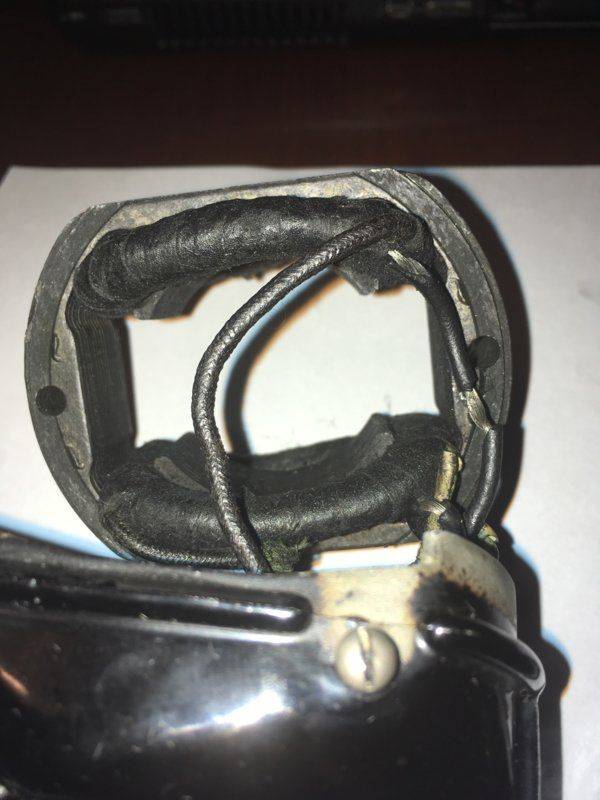

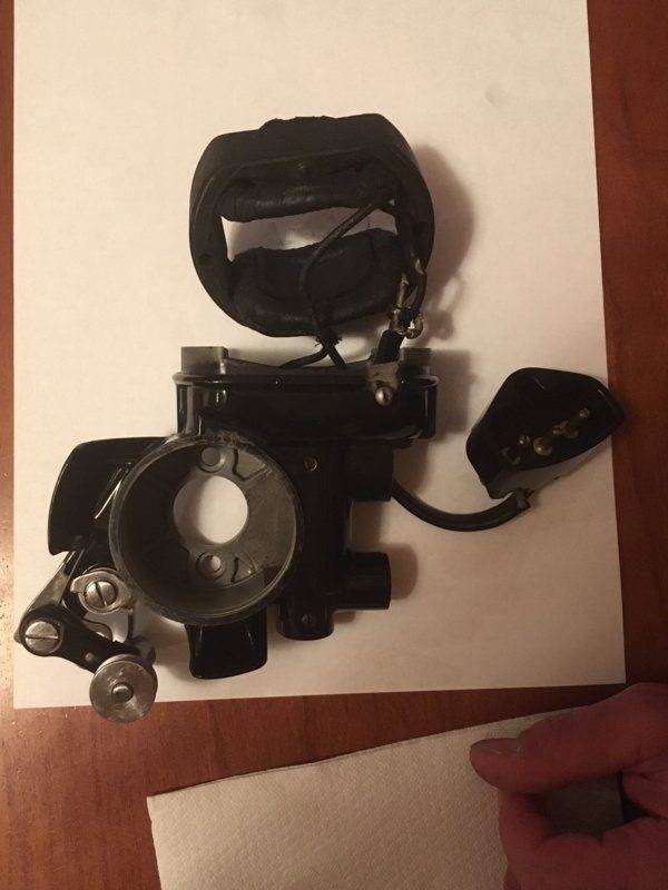

Here are picks of the motor finally. The motor is a direct drive with no belt. There is a worm gear inside the motor when assembled. It drives a helical gear on the hand wheel. There are two windings in the field core. One connects to line and the other connects to neutral. Each winding also connects to a brush. The leads are in bad shape especially the ones to the power cord. The conductors are exposed in where I can't get to in order to splice. I have the black friction tape they used in these things. I'm wondering what it will take to redo these windings. By the way I have a rust eraser from japan for cleaning sushi knives. I never thought to use it to clean commutators. Cool idea, will try thanks!.
Wow is that an old gear drive Singer ? Highly prized by professional dressmakers.
Your photos don't look that bad to me.
I'd clean it up
repair that bare spot on the wire with heatshrink
and give it a try.
Carbon and grime in the brusholders often makes the brushes stick and lose contact.
Be careful cleaning the commutator, don't use sandpaper or anything that can leave grit embedded in the copper. The 'orange stick' wooden utensil that ladies use for dressing their fingernails works well.
With your ohmmeter make sure nothing is shorted to frame.

Hi Jim, To remove the screws under the hand wheel you just need a good fitting screwdriver to start with. With the sewing machine in it's normal orientation, align the screwdriver with the screw and give it a moderate whack with a hammer. It sounds stupid but I've done this 3 times and have never done any damage. I learned that tip from Thrifty Farm Girl who restores vintage sewing machines as an online business. I used to tip the sewing machine on edge but that takes two people. One to hold it there and one with the hammer and screw driver. I don't even use PB blaster anymore for those two screws. By the way PB blaster is great for sewing machines since it's usually not rust that makes the screws stick it's old sewing machine oil. PB Blaster seems to penetrate and dissolve it.
There isn't enough wire protruding for shrink wrap. That's why I'm looking for a dead one to reverse engineer. I can probably help with your clean up since since I've been through it. I'm not an expert but have learned stuff from previous mistakes. If your model is from the 40s or 50s it should clean up really nice. The ones from the 30s weren't plated as well and the metal parts don't seem polish up as well. They're still nice though. The one I'm doing now is from the 30s.

i guess this is the area of concern... probably on the other side too ?
244397
underneath that tape probably within a half inch is the soldered joint between that big wire and the fine magnet wire they used for the coil itself.
Only as a last resort do i ever attempt a repair there.
Were this mine i think
i'd try to attach a new flexible lead at that bare spot where it comes out from under the tape
then immobilize that joint with enough epoxy to run over to the frame
where if you clean the metal well with alcohol first the epoxy should adhere
and it'll look like a repair encased in amber.

Hey guys. Yup that's the area I'm worried about. Never saw one this bad. If I can't find a coil to reverse engineer, I'll have to do something like what you're suggesting. The black stuff on the spring is actually carbon and grease. It gets everywhere. I cleaned the motor body but not the brushes and springs. If I clean the springs and they still look black, then they probably did get hot. Someone over greased the gears and it creeped everywhere. The motor has two felt grease wicks for the bearings. The grease has to be able to melt at 115F so it flows. I wouldn't use that grease for the gears because of the creeping. Someone used the same grease for everything and a lot it. I think that's what destroyed the wiring. There is a path from the wick reservoir to inside the motor. I don't know why they did that but the main way it's getting is through the gears. The worm gear just flings it everywhere. I found a gear grease that stays put and recommended for sewing machines.

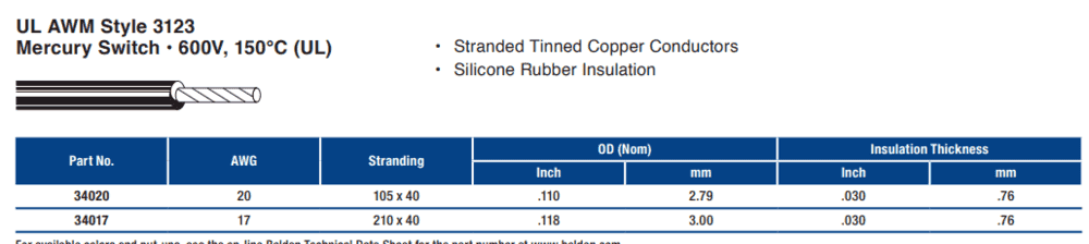

I don't know where to buy that ultra-fine stranded wire for motor leads.
Probably Alpha or Belden catalogs have some.
I'll look when get home.
old jim
Thanks Jim, I think it might be magnet wire or something like that. If I ever find a dead motor I'll find out. If I can't find one soon I'll have to make this one work as is. I have the manuals to the machine assuming you have 15-91. It could be 201 also. They both used the same motor. When you get your motor off I'll give you more details on tools/techniques I used. It might not be obvious what to do since everything will be covered with carbon and grease.
