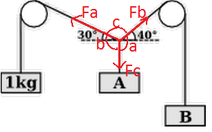

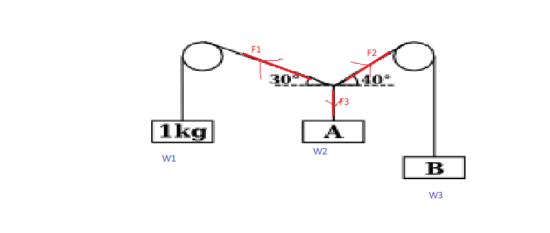

For some reason, this question's really stumped me. The text reads:
"The system shown is in static equilibrium. Use the principle of virtual work to find the weights A and B. Neglect the weight of the strings and the friction in the pulleys."
And has the accompanying diagram:
http://img143.imageshack.us/img143/9292/path2405.png
EDIT: oops; that 40° should read 45°; sorry about that.
For variables, I think we have:
A and B (obviously)
Perhaps rope tension?
Not sure, to be honest.
Based on what I've looked at previously with the principle of virtual work, I'd say I would have to generate a pair of equations based on the imagined movement of the weights and then solve the two simultaneously to get the values for A and B, but it's here it all falls down: I can't figure out how far the 1kg weight would rise if weight A fell, say, 2 metres. Of course, this method could be fundamentally flawed anyway and it wouldn't really matter.
