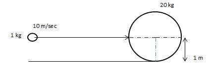

A 1 kg mass of clay, moving with a velocity of 10 m/s, strickes a stationary wheel and sticks to it. The solid wheel has a mass of 20 kg and a radius of 1m. Assuming that the wheel is set into pure rolling motion, the angular velocity of the wheel immediately after the impact is approximately.
##L_{i} = mvr = 1*10*1 = 10##,
##L_{f} = mv_{cm}r + Iω##
##= 20*rω*r + (mr^2 ω)/2 = 20ω + 10ω##
##L_{f} =30 ω##
##L_{i} = Lf##
##10 = 30 ω##
##ω = \large\frac {1}{3} \;\normalsize rad/sec##

Why we have to add ##Iω## to final angular momentum; ##L_{f}##?

The angular momenta are with respect to the contact point of the wheel with the ground (if it would not be, angular momentum would not be conserved because there are forces acting there such as friction). Knowing that, it is just an application of the parallel axis theorem.

Edit: Note that the solution is wrong. It is not taking into account that the mass of the clay after impact. As the mass is 1/20 of the wheel's mass, the error introduced by this should be expected to be in the range 2-15% or so.

It is very important to understand that torque, moment of inertia and angular momentum are each relative to an axis. For the angular momentum about the mass centre the linear velocity doesn’t matter, but here the solver has chosen an axis at ground level.
If a particle mass m at position ##\vec r## relative to the axis is moving with velocity ##\vec v## then its angular momentum about the axis is ##m\vec r\times\vec v##. In the question above, the clay starts with angular momentum mvr about an axis on the ground.
There is a good reason for choosing the axis at ground level. When the clay hits the wheel we are told that the wheel immediately commences rolling motion. That implies there is a strong frictional force at the ground to prevent slipping. (A toothed wheel on a toothed rack would be a good model.) By choosing the axis at ground level, this force exerts no torque, so angular momentum about it is conserved.
