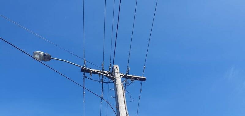

Nathi ORea
82
TL;DR Summary

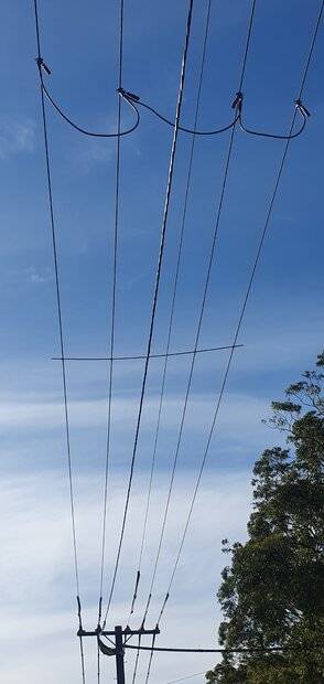

I am interesting in knowing what these 'wires' are that seem to be connecting these powerlines. I don't know much about electricity, but isn't 3 lines the various phases and one a neutral wire? Is this right?
Why would they join them like this?
There is construction a little further down (should be able to see in the photo). Maybe that has something to do with it.
I am in Australia, near Sydney, if that helps.
My guess is that they are a safety short on de-energized powerlines while they are being worked on, but that's just a guess. @anorlunda would know for sure.
  • Love
Likes davenn, DaveE and Nathi ORea
I agree with @berkeman , shorting cables protecting workers working on the line.However, that is a very strange line. I see 5 strings of insulators, indicating 5 conductors. 5?! Nobody uses 5 to my knowledge.There is also a second set of shorting wires visible. Three also appears to be a 6th site with no insulators, and something resembling a hammock on the pole.
Therefore, I can't rule out something bizarre and unconventional instead of shorting straps.
Likes jim mcnamara, Keith_McClary and Nathi ORea
OP says he is from Australia, so maybe @davenn can comment.
Wait,what?! Maybe for mandated rest periods?
Likes Nathi ORea

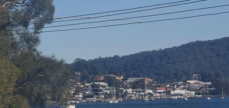

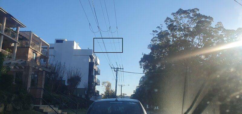

Thank you so much for your reply!
The 5 does look a little out of the ordinary, if I get what you mean. There usually seems to be only 4. I put a picture of the wires just in front of my house.
Is the boxed thing the 'second set of shorting wires' you mean? They seem to be everywhere. I assumed they are non-conductive rods just to keep the wires apart in case of wind or whatever else?
Here are some in front of my house.
The lower one is the phone line.
Of course those aren't temporary shorts. The rigid rods are indeed to add structural separation to the wires. That is completely different from the hanging shorting wire assemblies with the mechanical clamp jaws holding them onto the wires.
Was the power out to your neighborhood when you took this picture? If not, that would be very strange.
Likes Nathi ORea
I am not sure if power was cut. I just drove past it and wondered these clamps were connecting the wires. This is a bit away from my house.
Sorry. I can't see a second set then.
Can I ask what those rods are made from? They look metallic to me.

The straight connector is a white fiberglass rod that prevents wires swinging and contacting in strong winds. They do funny things here in Australia, the fiberglass rods are also used to support electric fences.
Likes Nathi ORea, anorlunda and berkeman
Ha ha.. What do you mean by funny? The rods aren't usually used overseas?
They don't ever seem to look 'white'?
Thanks so much for your reply
That is probably because of atmospheric polution.
Down here everything is washed by the purest of rain.
My guess is that the fifth wire is an Earth wire to handle the electrical storm currents. It is mounted on an insulator to prevent pole currents that would otherwise set fire to the dry wooden poles.
Likes Nathi ORea

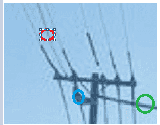

That's possible, but there is no reason a shield wire should have exactly the same length of insulation string as the power lines. Shield wires are grounded as soon as possible because we don't want the surge jumping the air gap to other conductors.
There's still a 6th mystery wire with no insulators. I circled it in red. It can't be phone or Internet, because those things are always lower on the pole than power lines.
And a mystery object I marked in blue. and a single wire circled in green leading down to somewhere.
Likes Nathi ORea
The red and green circles mark bundles of four insulated wires going to the customers premises. A catenary wire would have an insulator and be anchored to an eye-bolt through the pole.
I think the blue circle marks the where the two bundles are being gathered. There may also be service fuses there, which would explain the bulk.
Likes Nathi ORea
6th wire: I saw similar thick, twisted wires in PL. I was always under impression they are for telecom/internet connections, just reusing existing poles.
Likes Klystron, Nathi ORea and Keith_McClary

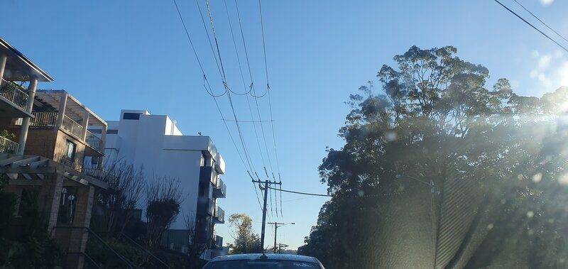

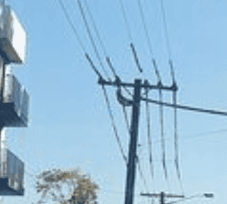

Ok. so I drove past those lines again, and I tried to take some better pictures.
Here are the two posts which the clamp wires were between. You can see the wire clamps, and the hammock pole off in the distance
A look up at the first post. Do all these wires seem to be going into the one that's below?

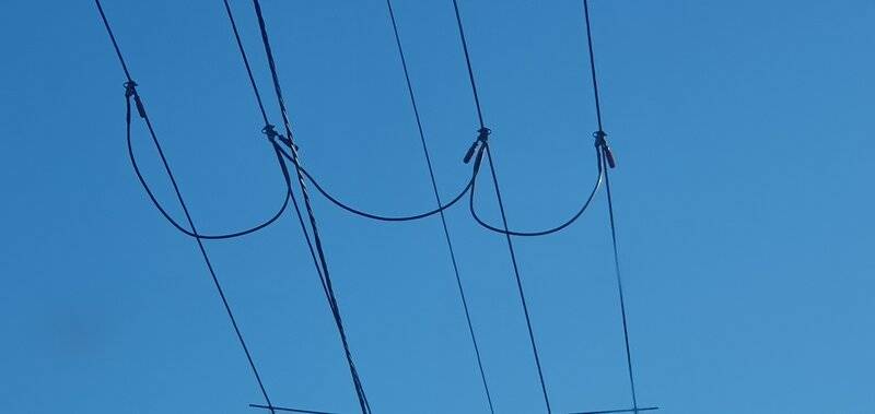

Then here are these clamps I was wondering about and the other post with the hammock.

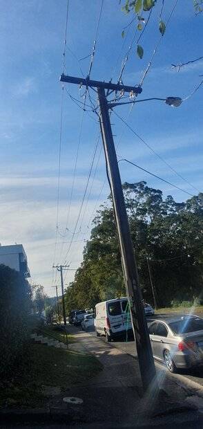

Then here is a picture of the 'hammock' pole.
Does this make it any clearer as to why these wires would be connected like this. It is kinda killing me.
I have really enjoyed all your input so far!
There doesn't seem to be any work being done in the area, but maybe there was recently. Surely this area would not be without power for this long.
The fifth wire could be the street light power that turns the lights on at night.
The "hammock" is insulation, with black and yellow stripes. It suggests that a crane has been operating above the wires.
The insulation would be installed for a period of time during construction of the adjacent building.
The insulation is often long term and is probably quite independent of the Earth jumper leads, which would only be used for a short period, unless the power had been transferred to underground.
Likes Nathi ORea
That's much better. It looks like two single-phase circuits, possibly with a shield wire on top. The wires going down and diagonally are to a customer's entrance (as @Baluncore said).
I still think the jumper wires are shorts. It could be that service to those two single-phase circuits is cut off for reasons we don't know.
It could be that the yellow insulation blanket was there because men were working up there. They could remove the blanket before removing the shorting straps to restore those circuits.
Just because those circuits are shorted, does not imply that any customers are out of service. Most distribution circuits make a U shaped round trip from/to the substation. You can cut out anyone section of the U and everyone still gets power, although the direction of power flow in parts of the wires may reverse.
Real life power distribution can be very messy. It's hard to make any general statement which is always true. Therefore any answers in this thread (especially mine :wink: ) may be incorrect.
Likes Nathi ORea and Windadct

Nathi ORea said:
So what would the shorts actually do in that case? Safety for workers (like someone said before)?
Yes safety for workers.

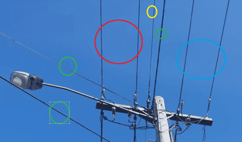

Nathi ORea said:
I would really appreciate that you point out what the two single-phase circuits are? I thought there was three.
Red single phase circuit 1
Blue single phase circuit 2
Yellow, shield wire lightning protection.
Three Green, cable bundles heading off to customer houses.
Most common, three phase power, is not shown in your pictures. You can learn the basics about three phase power on Wikipedia.
https://en.wikipedia.org/wiki/Three-phase_electric_power
Likes Nathi ORea
In Australia we do not use split phase, we distribute 3 phases and have a local Multiply Earthed Neutral, MEN. If you follow those lines to the end of the street and around the corner you will find a transformer, or the end of the lines. Rings are rarely used here as the suburban growth forms a star network and domestic power is not deemed critical.
To balance the load, alternate small customers get N and one 230V phase. The thin bundles of two twisted wires are 1PH supply to a small customer.
Bigger customers get N and all three 230V phases, = 400V, 3PH. The thick bundles of 4 insulated wires are the 3PH supplies going to bigger customers.
The street lights are controlled by a single wire. To test street lights, the area is enabled then they drive along the streets during the day.
In those pictures I see the neutral, three phases, and street light control, with diagonal bundles to customers.
If the jumper clips remain in place, I would look to see if the power has gone underground.
Likes Klystron, Nathi ORea, berkeman and 1 other person

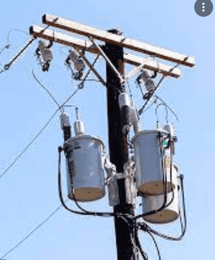

But lest American viewers try to interpret that, the split phase used in America is done on the customer side of the distribution transformer. Overhead on the poles you will never see a neutral wire. (I know, never say never.) Overhead you will see only single-phase circuit(s) [two conductors each] or three-phase circuit(s) [three conductors each].
And in the American system, there is one distribution transformer for each customer [perhaps 2-3 customers], not one for a whole neighborhood or a whole street.

If the looped wires are for worker safety, I believe the initial question that has been answered by describing the wires as providing a short circuit to protect workers would more accurately, and more specifically, be described as bonding wires, which connect both cables so that any existing difference in voltage between the cables will be eliminated (equalized) by the bonding wires, thus preventing any difference in voltage between the cables that could travel through a person or bird that is too close to both cables as the difference in voltage between the cables attempts to equalize. Any existing difference in voltage between the cables travels through the path of least resistance (the bonding wire) instead of anything or person that gets too close to both cables. I say "too close" instead of "touching" because the very high voltage on the cables can arc between the cable and person without contact.
Likes Nathi ORea
You can identify the voltage by examining the length of the insulator strings used. The differential voltage between anyone of those lines and ground is 240 VAC, the same as is present at a power point outlet in the house.
Likes Nathi ORea
Actually, the shorting straps trigger a trip of a remote circuit breaker in case someone accidentally tries to energize that line.
Residual charges are not the biggest concern. The full voltage and current capabilities of the line in case of accidental energization is the concern.
The most severe electric contingency a power plant can have is to accidentally close the breaker when three phase shorting straps are installed close to the plant. It can set the maximum current interruption requirement for the plant's main circuit breaker.
I remember one incident 40+ years ago when that happened, and the breaker failed to interrupt. The fault propagated back from the high side to the low side and into the isolated phase bus ducts back to the generator. That caused a hydrogen explosion, which broke the shaft, which then triggered a lube oil fire. It destroyed most of the plant. However, if there were any linemen working out past those shorting straps, they were protected.
Yippee! That was my guess, and I am not even an Aussie! :biggrin:
