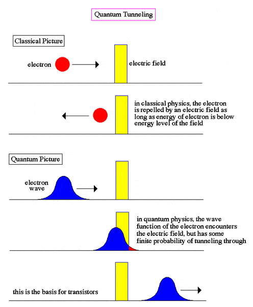

This is interesting. So how is quantum tunneling achieved; and what process must be undergone to make it possible?
No additional actions are required for this. It is just due to the fundamental nature of the particles, which are described by quantum wave functions, that there is a finite probability that the particle-wave at the moment of the interaction just "leaks" thought the other particle-wave like a ghost through a wall. The probability that this happens is low, but not 0. Given the amount of such interactions in the core of the reactor, most of them are scatterings and absoprtions, but luckily some are quantum-tunnelings leading to the fusion of the atoms.
Here's a picture explaining the effect:
Source: http://abyss.uoregon.edu/~js/ast123/lectures/lec06.html
