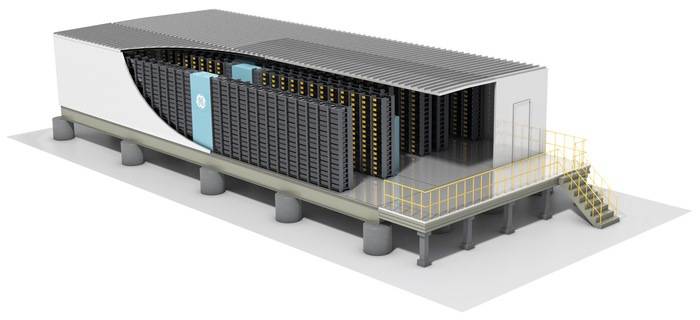

For starters what is your budget? Based on the numbers in your OP, you need more than 100 MWh of energy storage.
In very rough numbers, the batteries alone will cost nearly a quarter million dollars, the whole project perhaps $1 million. That puts you in the utility scale energy storage.
General Electric makes battery systems in that size range for utility use. https://www.gerenewableenergy.com/innovative-solutions/energy-storage/energy-storage-technology.html
