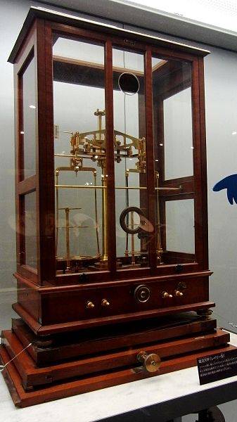

A current balance is the standard way to measure current from scratch, I believe.

But have you ever tried to picture a device to measure amperes based on the definition?
Can you imagine Fluke trying to sell 100 meter long(infinity is a long way), 1 meter diameter vacuum tubes, with little springs and levers to measure the sub-micro Newton forces?
Hmmm... Come to think of it.
Ampere balance ... in the National Museum of Nature and Science, Tokyo, Japan.
That probably wouldn't fit on my tool-belt either.

Afaik, the SI definition of the Amp is based on the Current Balance.
