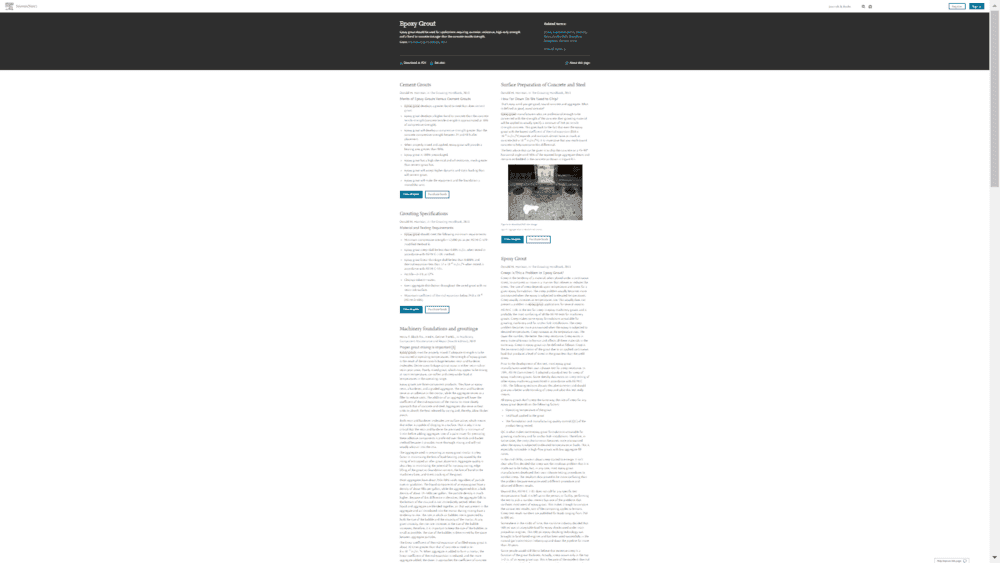

I couldn't find a direct answer to your question but felt you might be interested in this article about epoxy grouts pros and cons:
https://www.sciencedirect.com/topics/engineering/epoxy-grout
Thanks, but unfortunately it seems to be behind a paywall.

That’s odd. I can see it at home. Maybe it’s country walled.
The article had info on grout tensile strength vs concrete tensile strength and expansion rates of both materials. It had some pros and cons related to discoloring too.

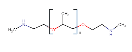

I'm pretty sure the MSDS is just listing the polymer as the developed (uncured) polymer, derived from the epoxide starting monomer. It's not a silicone (no silicon) and it's not a polyurethane (no amide). The structure is a polyethylene glycol (PEG) derivative:
The PEG structure is typical of polymerized epoxides. The diamine is the curing (crosslinking) agent. If I had to guess, I'd say the rest of the active ingredients are preservatives: benzyl alcohol is probably some sort of stabilizer (maybe a radical scavenger), the quartz is probably a dessicant, and the barium hydrosulfate is probably a buffer.

TeethWhitener said:
The structure is a polyethylene glycol (PEG) derivative: [...]
Thanks. So I guess this is what Wikipedia calls a "polyol" on its polyurethane page (which seems to cover a vast range of compounds -- but also says it "needs attention from an expert in chemistry").
A polyol is a simply a compound with multiple hydroxyl groups. It’s not necessarily a polymer. Ethylene glycol is a diol (two hydroxyl groups), and is one of the simplest polyols. The suffix -ol just denotes the presence of a hydroxyl functional group (-OH).
Polyurethanes are generally made by reacting a polyol (like ethylene glycol) with a diisocyanate. PEG is a condensation (loss of H2O) product of ethylene glycol. Probably confusingly for the non-chemist, poly(ethylene glycol) is a polymer with no hydroxyl groups (except at the ends of the polymer chains) which is itself made up of monomers that are non-polymeric polyols. Polymer nomenclature is tricky.

Is it possible y'both are describing the same thing but with different expectations?
I see a page that's about 15 screens long and full of info, but in the form of what appear to be excerpts from some book, which you can buy.
Likes jedishrfu
Yes that’s what I saw, the info though was somewhat useful with pros and cons of epoxies, and various tensile strength numbers.
I don’t think anyone would call this a derivative of PEG. Perhaps PPG but not some version or derivative of PEG. This, however, is clearly polypropylene oxide with amine terminations. That’s only the resin part of this product. The active epoxide isn’t listed. The percentages only add up to 45%! The other 55% is described as “non-hazardous” but I’m sure it’s the reactive part of the system. Likely diglycidyl ether... reactive diluent.
There is a slower reaction that continues the hardening process after the initial gel (rubbery) stage. Not sure of all the reactions going on but you have difunctional primary and secondary amines in the mix with some epoxy group that isn’t listed in the MSDS. Lotta stuff going on. Benzyl alcohol is also used as a thinner and a solvent for the amine hardener, which might not be soluble in the epoxy resin/reactive mixture.
PEG is usually made from ethylene oxide AND ethylene glycol, not a condensation of ethylene glycol itself. The monomer is ethylene oxide not ethylene glycol.
