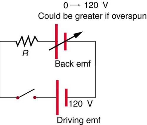

Based on my explanation of what causes an AC motor to pull locked rotor amps in post #7, do i seem to understand the gist of what causes an AC motor to pull locked rotor amps?

It has raised a linguistic point about the meaning of ‘opposite’ in electrical terms. When the rotor spins, it induces a voltage that is the same polarity as the input, and so it acts in opposition. So the back EMF is simultaneously the same and opposite polarity.
I don't understand this. I thought that the back EMF is the opposite to the applied voltage. How is the back EMF simultaneously the same and opposite polarity?
Ignore R. The EMFs are opposite in terms of which way they will try to drive current. This is the way to think about your original question.
But if the EMFs are connected + to +, and - to -, would you not call this the same polarity, ie like connected to like?
Add a likely load in parallel with the motor, such as ‘motor running’ indicator lamp. You haven’t changed the EMF connections, but now you would say both are in parallel with the lamp. Draw it out and tell us what you think.
back EMF cannot be 180 degrees out of phase as @essenmein already said because that would mean that there would be a potential difference and the higher the potential difference (Voltage) between two points the higher the current so as back EMF would increase current would also increase, but we know that this is not the case!
Instead as back EMF increases current through a motor decreases so apparently the Potential difference across the motor has decreased , but how can this happen if the socket in which the motor is plugged has the same voltage , say 230V as before right?
Simple, a spinning especially unloaded motor behaves a bit like a generator so the back EMF produces it's own voltage which is IN phase with the supplied voltage,
so in theory for a motor with permanent magnets in rotor if the motor was spinning and the plug was pulled from the wall the motor would still produce some 95% of the voltage it was supplied with , this voltage would decrease as the rotor RPM decreases.@timmeister37 So Imagine you have a permanent magnet motor like this and you run it from your wall socket , the motor spins, now for some reason electricity goes down and lights go dark, in the same socket you had the motor you also have a light bulb in parallel. Even though the electricity would switch off instantly , your light bulb would not go out instantly but instead glow for a while with a diminishing glow because now the motor becomes a generator , but if you started cranking it with hand (assuming you could do it fast enough) the bulb would continue shining and if you probed the wires with a scope the waveform would seem the same just like it was when the electricity was supplied from the grid.
sure in reality the frequency would change etc because your hand cranking would not be stable etc but that is a different topic.
