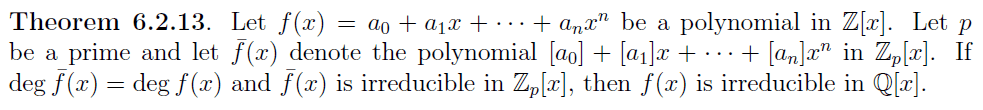

Your Theorem 6.2.13 says that if $\deg \overline{f}(x) = \deg f(x)$ and $\overline{f}(x)$ is irreducible in $\Bbb{Z}_p[x]$ then $f(x)$ is irreducible in $\Bbb{Q}[x]$. The theorem does not tell you anything at all about what might happen when $\overline{f}(x)$ is reducible in $\Bbb{Z}_p[x]$. So the fact that your $\overline{f}(x)$ is reducible in $\Bbb{Z}_3[x]$ does not imply that ${f}(x)$ is reducible in $\Bbb{Q}[x]$. That would amount to saying that the converse of Theorem 6.2.13 is true, which is certainly not the case.
The technique of looking at $\overline{f}(x)$ in $\Bbb{Z}_p[x]$ is a one-way test. You can use it to prove irreducibility of $f(x)$, but you cannot use it to prove reducibility.
