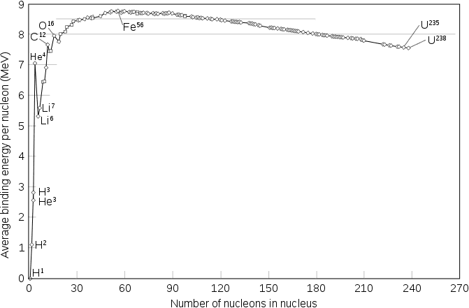

Karagoz said:
If I did get it right, atoms that weigh lower than Fe (iron) give up energy in fusion and absorb energy in fission. But atoms that weigh higher than Fe give up energy in fission and absorb energy in fission. This is not without exception (according to the graph below taken from Wikipedia, as the line goes up and down between He, Li, C etc.).
That graph shows that Fe56 has the highest binding energy per nucleon, without exception, evidenced by the fact that there's nothing with a higher binding energy per nucleon! The wiggles around He and Li do not demonstrate an exception. They demonstrate that the maximum at Fe56 is not approached smoothly.
But what I didn't get is, why is it that?
Are you asking why the element with the highest binding energy per nucleon is the most stable? Or are you asking what it is about that particular number of nucleons that makes it the one with the highest binding energy per nucleon?
The first question almost answers itself and thus answers your fusion versus fission question. I don't know the answer to the second question beyond what the others have already mentioned.
In this graph: you see that Fe has least mass per nucleon.
http://dev.physicslab.org/img/7b784857-7639-45de-bd2e-32cdeb2dabdc.gif
But Fe has highest binding energy per nucleon, like you see in this graph:
https://cnx.org/resources/72ec9ed4c72df1425d0318f15a94e3c8247182bb/Figure_32_06_03a.jpg
Is there a relationship between "average mass of per nucleon in nuclei" (or mass / nucleon) and "binding energy per nucleon"?
Also higher binding energy per nucleon, then less "mass / nucleon" will there be be?
If so, why is there such relationship or correlation?
The binding energy is just the difference between the mass of the nucleus and the sum of the masses of the particles in the nucleus, if those particles were all separated from each other. (And then converted to energy units, if necessary, via ##E=mc^2##.)
Edit: deleted some irrelevant and potentially misleading words
