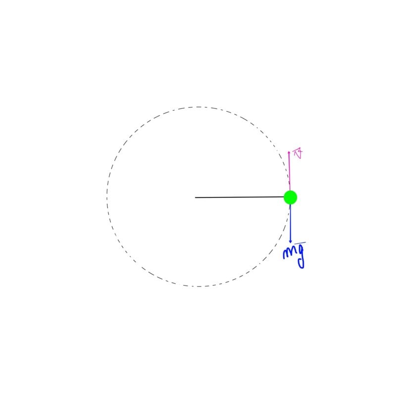

I don't get how ball moves in a vertical circle,we say tension provides centripetal force to the ball, i have posted a image in this post and in I which I have shown that their is a downward force mg and upward velocity,in this what will cause tension in the rope...from non inertial frame it is understandable that it is centrifugal force but I can't understand it from inertial frame of reference.

In the original question, where the rope moves in a vertical plane, are you having a constant angular velocity or allowing the rope to slow down as it climbs. To keep it at a constant speed, you would need to drive it (and brake it) on the way round and it would have to be rigid. Too hard for starters!
Likes Frigus
In this question the ball is tied to rope at one end and another end is fixed and in whole scenario only two forces are acting on the ball that are tension and the gravitational force,hence the rope is slowing down as it climbs.

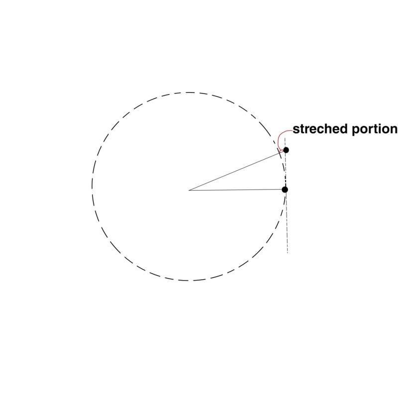

Can you please clear my another doubt.
I understand that the rope will stretch when the ball will go in straight will and I also have posted photo of this situation so one can clearly understand what scenario is in my mind,but now the thing which I can't understand is that how does ball streches the rope as ball is going with constant velocity but some force is required to stretch the rope
And also I tried to magnify the streching of rope so I can clearly show what is in my mind.

If I may try to state your conundrum.
"If the ball is going with constant velocity, it cannot be stretching the rope because it cannot be exerting any force on the rope."
The logic is impeccable. The above is a true statement. But let us proceed with the chain of logical inference.
"But the rope is tied to the ball. The ball cannot go straight at constant velocity without dragging the rope with it. If it did that, it would have to stretch the rope".
The conclusion we can draw from this is simple: "The ball does not go straight".
If one opens one's eyes and looks at the ball on the rope, this conclusion is manifestly true. The ball does not go straight.
