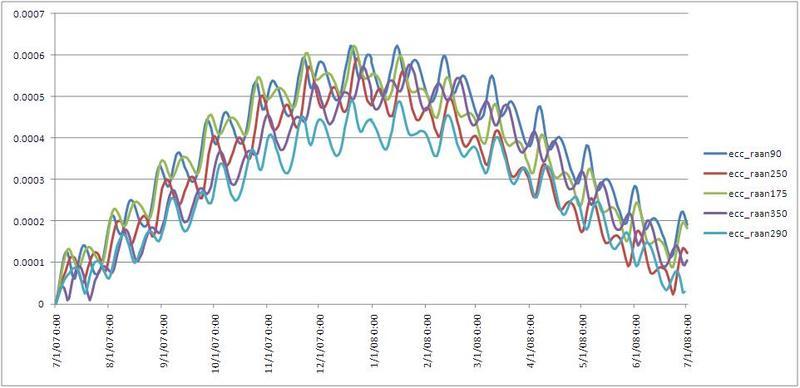

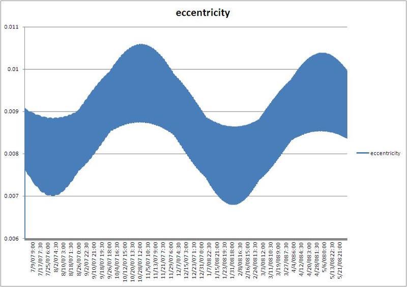

Just using SGP4 elsets from 2007 (after the satellite was put in a disposal orbit, but well before decay), you can picture both the short term perturbations and long term perturbations. The elsets are just propagated out, so this is based on models, rather than actual observations, but SGP 4 is a decent model.
The right ascension of ascending node rotates a complete 360 degrees in slightly less than 3 months and the argument of perigee advances a complete 360 degrees in approximately 6 months.
Just graphing eccentricity (which indirectly indicates that something is happening with perigee/apogee), you can see there's a lot of short term variations. But the only thing that shows on the graph in the original post are the long term variations. While D_H is right, I don't think the things he's talking about are showing on a graph that just maps the long term changes. I'd have to think about that awhile, though. I work with a lot of geos (a much quieter environment), but really haven't done much with low Earth orbits.

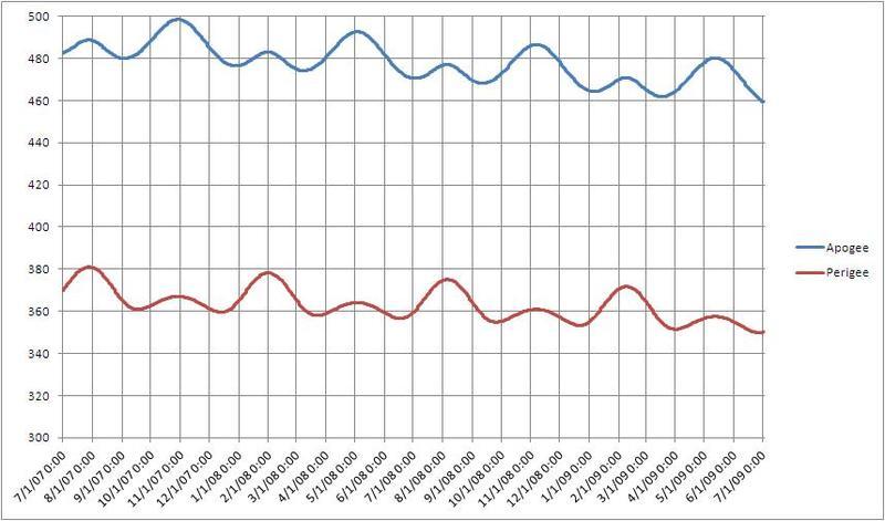

Plus perigee/apogee for a shorter time period, which makes it easier to see the detail.
And that pretty much explains it. I did not want to go into the Lagrange Planetary Equations in my original response; too much information and without the background it would just be a mathout. (And I still don't want to bother with the details of the math; it would beg too many questions).

There's no reason that effect would disappear for lower orbits, but the variation in eccentricity for UARS is about 4 to 5 times too big to be just because of the orientation of the orbit relative to the Sun.
