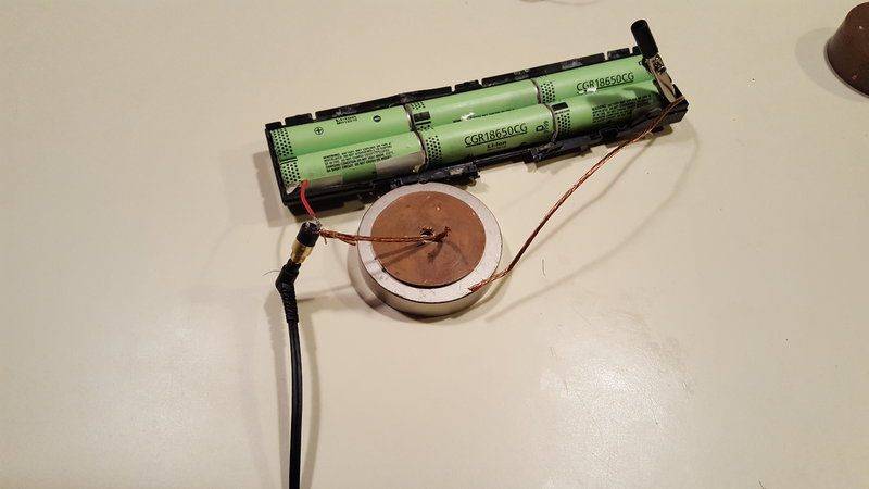

I did a little experiment the other day. It involved connecting headphones to a copper disc and a battery. Then I placed a magnet under the disc. When current flows with the magnet present I get this strange sound similar to squeezing ice. What am I hearing? I don't believe it to be the electrical contacts.
Think of a homopolar motor with the disc held stationary and headphones connected in series.
