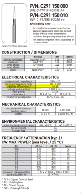

I have another question, based on the datasheet @alan123hk shared. I attached a partial screenshot.
(highlight mine)
What does this "shielding effectiveness" mean? Does that mean that if there is RFI, there will be 40dB less pickup in the core than in the shielding? (Wouldn't that actually be terrible for the RF signal?) Or does that mean that RFI, as measured differentially between the shielding and core is suppressed by 40dB? If that's the case, what's the 40dB relative to?
The signal inside a coaxial cable propagates as two equal and opposite currents. One current flows on the outside of the central conductor, with the other exactly opposite current, flowing on the inside of the braid. That common mode signal is almost inside a world of it's own.
There is another world outside the cable. The currents that flow on the outside of the braid are exactly mirrored by currents flowing on the surfaces in the external conductive world.
When measured in wavelengths, the holes in the braid are too small to pass much energy, so to a first approximation, the inside and outside of the braid form two distinct conductors. The shielding effectiveness specifies the attenuation between those two distinct surfaces of the braid.
The leakage through the shielding braid, is specified relative to the signal propagating on the source side of the braid. 40 dB of shielding represents an attenuation of the voltage or current by a factor of 100 when passing through the braid. That is equivalent to a power ratio of 10,000.

Calculating or estimating the actual situation of the interference of external electromagnetic fields on the transmission line may be a complicated problem.
However, from a physics point of view, the basic concepts and principles of this so-called shielding effectiveness are relatively simple and easy to understand.
Simply put, shielding effectiveness is how much electromagnetic waves attenuate after passing through the shielding layer.

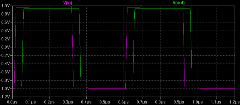

@berkeman I finally got around to doing the measurement you recommended in post #8. See below.
The blue (delayed) signal is the pulse train after it goes through the cable. Am I right to infer that the reflections are negligible?
After repeating my measurements with the square wave for 4 cables, I'm getting variations in velocity factor of about 2-3%, if anyone was curious.
Likes berkeman
Probably yes.
Your green received wave delayed by the one way transit time, T, looks good.
The slightly lower amplitude of the pink transmitted wave, for a period of 2T following an edge, appears to be due to the cable having a lower impedance than the signal generator or oscilloscope termination. The small reflection from the far end makes up the difference when it finally gets back to the start at 2T.
Likes dlgoff, berkeman, Twigg and 1 other person

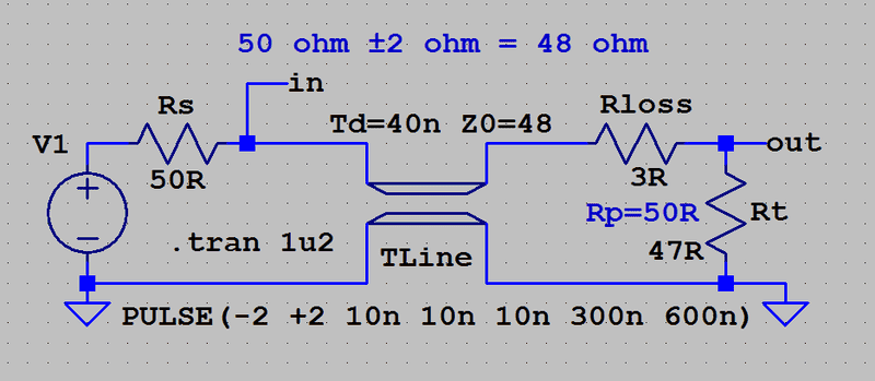

Here is an LTspice approximate simulation of the square wave test.
The signal generator is 50R series terminated into the cable.
The output is parallel terminated with 50R, 3R of which is dummy line-loss.
The manufacturer specifies the line as having an impedance of 50R ± 2R.
The line clearly has a lower than matched impedance.
So the lowest in-specification line impedance would be 48R.
Likes Twigg
