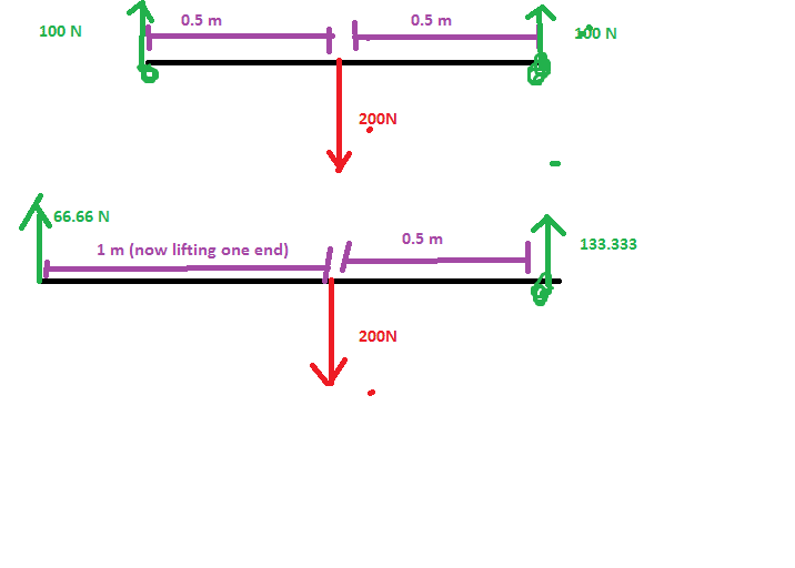

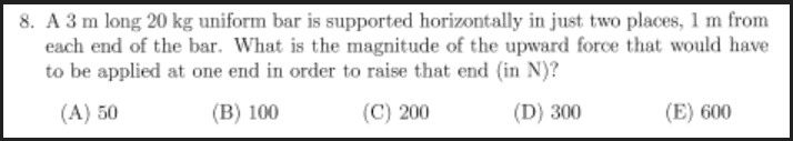

T = fd
f = mg
I appear to be suffering from autism.
Heres my working out...
F(bar) = 200
Two support forces of equal length, each 0.5 m from fulcrum (given). Therefore torque magnitude is the same. 100 N on both sides = counters 200 downwards. My answer is therefore B.
Answer sheet says that A.) is the right answer.
Can someone help me out, what did i miss? Thanks in advance for the help
