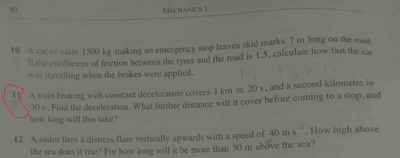

A train braking with constant deceleration covers ##1## km in ##20s##, and a second kilometre in ##30s##. Find the deceleration. What further distance will it cover before coming to a stop, and how long will this take?

There is. I can't read the problem, but I can tell you that plugging in numbers is the last step, not the first.

I re-typed the question.
