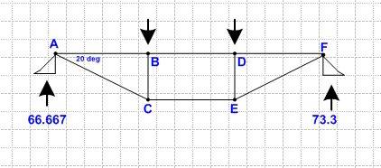

I am trying to analyse a truss using the method of joint process i.e I am trying to determine whether each member is in tension or compression.
I have the following truss that I want to analyse using the method of sections.

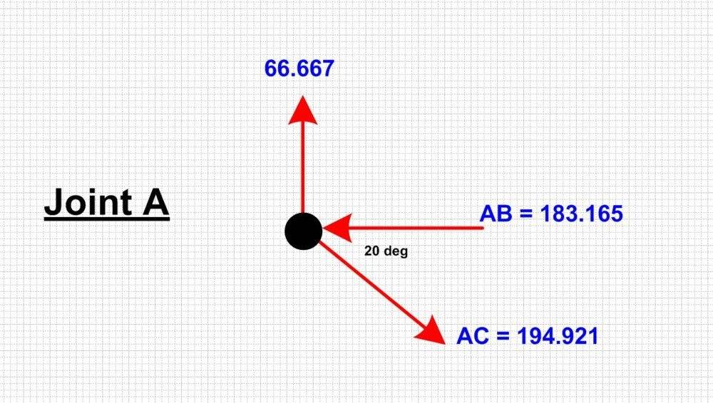

Just focusing on joint A, I have created a FDB and calculated all the forces:-
I know this is correct but I wanted to ask about the values of AB (183.165) & AC (194.921) - would I be correct in saying that the member AB is in compression and the compressive force through that member is 183.165kN, similarly would I be correct in saying that the member AC is in tension and the tensile forces through the member is 194.921kN?

Yes that is correct. With a correct free body diagram it is easy to determine whether a member is in compression or tension. Compression forces in members are pushing forces and always act toward the joint. Tension forces in members are pulling forces and always act away from the joint. When using the method of sections, compression forces act toward the member and tension forces pull away from the member.
You asked what the numbers mean? These are the forces in the members used for member design. Compression forces subject members to buckling and are often more critical for equal size members .

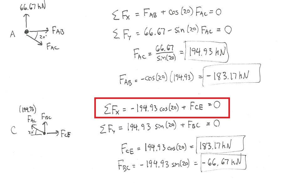

I have the same question shown below:-

Focusing on just joints A & C the calculations are :-
I was wondering if you knew why 194.93 was Negative I am really struggling to figure out why it would be a negative value when checking for compression/tension at joint C when at Joint A it was a Postive Tension?

Oh the darn minus sign is always cause for confusion, so it’s perhaps not as easy as I mentioned.
First off, look at joint A. In your first post, you chose the correct direction of the forces. But in your second post, at joint A, you assumed the wrong direction for Force AB, and got a negative number for force AB. That negative number means you assumed the wrong direction for ForceAB, that is, it actually acts towards the joint as in your first post, not away from the joint which you assumed. The negative sign here means you assumed that he wrong direction for that force. I does not mean the force is a compression force. So immediately change your free body diagram to show F-AB acting toward the joint to the left, making it a compressive force because it acts toward the joint.
Now move to joint C. You know that Force AC is a tension force. So at Joint C it must pull away from the joint, as you have shown. Then when you sum forces in the x direction, it is a minus number for the x component because it acts left, but that doesn’t stop it from being a tension force. Note that you got a negative number for force BC. What does that mean? Tough question.
