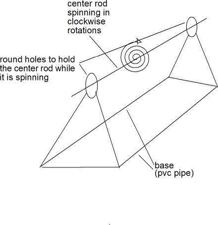

i'm not sure if this is going to work but I'm trying to attach a crude picture i made of what it will look similar to.
the picture is basically a base (which I'm thinking about using pvc pipe or wood for) two holes on either side to hold the rod in the middle that will be spinning and the support poles to hold those up. to explain what it means... the rod going between the two circles is going to be spinning (i'm not exactly sure how fast but it will be spinning alot) and it will be made out of the same material as the rest of it. the base is just there to hold it off the ground to give it room to spin. I'm trying to figure out what material will be a low cost and easy to work with material suitable to withstand a lot of friction (and heat from it) without melting or breaking, that also will not conduct electricity.
i'm hoping this will give all you who wanted more info enough to work with.

This is a crude solution... but then again, I'm a crude person. I'd just knock the tops off of a couple of beer bottles and use them as bearing surfaces. If you need tight tolerances, invest in a piece of suitably sized glass tubing.

Obviously you are going to want to have the center rod as balanced as possible, otherwise once the spinning starts, you are going to have some issues. For the ends, would it be possible to get some wheels off of a set or roller blades from a second hand shop, and then built a bracket which you can mount them on. If you place them at 12 o'clock, 3, 6, and 9 (or N,E,S,W), and leave a slot for small adjustments, you could have the rod spin on the rollers. That should be relatively low in friction...and cheap.

Your picture is indeed crude, and unless you are trying to conseal the real plan, i would guess the drawing is in some way close to proportion of what you are thinking.
The rod or pipe that is spinning, can use regular bearings set in pvc fittings, and will be free of electrical conduction, but from what to where?:confused:
As Danger said, the beer bottle can be used, but thermal shock will render the glass to a marginal use.
Without more specific detail, it might as well be a segmented, rolled aluminium capacitor, sending spikes of electrical impluses to a DC motor comutator.( just one of many thoughts):rolleyes:

first off yes i am trying to conceal my real plan because i believe if i give out to much information someone will beat me to getting it built and i don't want that.
second the roller blade wheels is a very good idea that i never even came close to thinking about. thank you very much for that. but i am a little confused about the whole 12 3 6 9 thing. I'm not exactly sure what i need 4 points for. it is going to be one rod secured between two points and attached to motor to spin it. so if you could explain what the other two points are for that would make me a lot less confused dingpud.
How fast are you thinking about spinning the disc/rod? How long do you think the rod will be? How heavy is the disc?
Maybe I've never had a good one, but you would surprised at how hard it is to get someone to beat you to a plan
Kind of like a dead center on a lathe (I think that is what it is called). It helps minimize vibrations at the end of the spinning rod. two wheels would be sufficient as a roller rest. Additional rollers would be used if you wanted to put a small amount of force downward.

attached is the 5 minute sketch. the slots in the mounting plate will allow you to adjust the amount of force each wheel is applying on the spinning rod.
