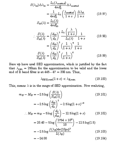

When referring to the absolute magnitude ,for example, in the B filter of a distant galaxy(considered point source) what are we talking about? Are we talking about the observed redshifted flux density(luminosity density) hypothetically seen from 10 pc away (1) ; or are we talking about the actual intinsic flux density hypothetically seen form 10 pc away (2)?
I encountered an exercises in which it is written that (1) is the case but I don't undesrand why. Is it because the blue (B) in (1) is diffrent from the B in (2) because of the redshift?
