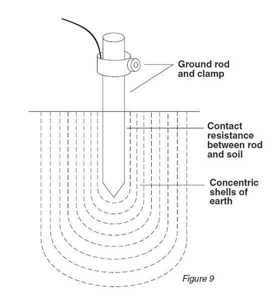

I remember being surprised how much I didn't know about grounding when it came time to learn how to use a "ground Megger" and interpret the results. R=pl/A is but a starting point, but as @jim hardy and @Baluncore point out, coming close to an understanding what's actually going on is a wilder and woolier ride. Biddle has a good write-up of the basics, and is worth reading by anyone interested in what constitutes Earth ground.
www.weschler.com/_upload/sitepdfs/techref/gettingdowntoearth.pdf
Resistance varies in the manner of concentric shells around a grounding point, and is the reason behind step potential, and using a "bunny hop" or "shuffle step" technique to escape the vicinity of a downed power line (images were copped from a BC Hydro slide show and the document above).
