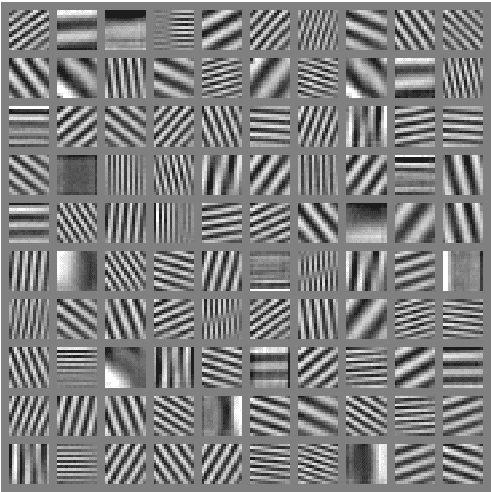

sir you can consider basis functions instead of basis images also instead of video you can also refer the below image which shows few plots of different extracted waves from an image
The shown images "below" in #5 looks like extraction from a spatial image ( not at Fourier power-plot ). If they were an extraction from a fourier-plot, I'd like to see the corresponding spatial image. You would extract both high and low frequenies by using these patterns, and that is not what is seen in the left and right video in #1. Here at first low frequencies are extracted, then higher frequencies. Look at the middle video, showing the corresponding spatial part that are extracted, showing an image with finer an finer "granularity": This means that concentric circles with growing radius are successive extracted.

Hesch said:
Do you mean the first extraction: It looks like a wave from a tsunami. And yes, it should have variations in all direction ( well, at least in 4 " ±directions " ) as for the 1. harmonic, due to discreet data in the fourier-transform.
But in the picture of the first extraction, it looks like the intensity only varies from left to right. If the first extraction was a harmonic, it would presumably have an intensity that varies in both directions. i.e. it would not look like a tsunami wave. Therefore, I think that each extraction is a plane wave, not a harmonic. In two dimensions, you can use a Fourier series which is made up of plane waves to represent a 2-d function (i.e. a grayscale picture), by this equation:
[tex]f(x,y)= \displaystyle\sum_{j,k} \ C_{j,k} \ \cos( jx+ky+ \phi_{j,k} ) [/tex]
where the sum is over the positive integers. As long as you use enough terms here, you should be able to approximate any 'nice' and smooth function (on a finite interval). And note that each term is just a plane wave. In the video, each extraction looks like a plane wave, so therefore I think the person is using this equation. (again, I'm not certain about this, it's just my first guess).
I agree, but what can I do?
I'm just looking at the left and right video, intensively watching what is happening here (regarding the middle video as a cartoon): The edges are sharpened vertical and horizontal at the same time, not at first the vertikal and then the horizontal edges.
