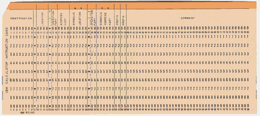

On input, the detailed specifications are useful if the numbers "run together" without blank spaces separating them. You can also even omit the decimal point, which was often done to save space and data-entry time in the days when 80-column punched cards were the norm for input. (Yes, I remember those days, just barely!) In commercial applications, the cards were often pre-printed with solid and dashed lines to separate the fields and locate the decimal points visually, and with some text along the top of the card to identify the fields, so that the keypunch operators could easily proofread their work.
For example, on a punched card, you could enter the four numbers in post #10 as
Code:
12345671234567-123456 123456
and read them using the format ('4f7.4'), getting the result that DrClaude indicated. You can do the same with your input data files if you want to mystify whoever reads them. :biggrin:
