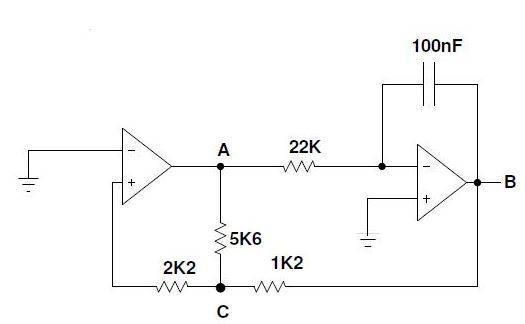

Trying to figure out what this opamp does but can't pinpoint it.

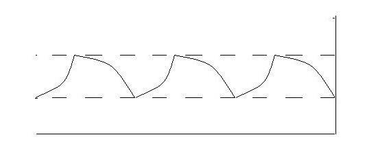

The one with the capacitor looks like an integrator. I attempted to build this circuit to see what it does. At node B I saw a triangle repeating waveform, node A gives a square oscillating waveform and C is some sort of horizontally flipped RC curve which can been seen with the file I attached. Anyone have any idea the name of this circuit?

Hint: The word you are looking for begins with an "O" and is used to describe a family of systems including a pendulum.
I'm still quite not sure.. The only thing that comes to mind is an oscillator?
Oscillator will do :-)
I suppose "Triangle Wave Oscillator" or "Hysteretic Oscillator" or "Relaxation Oscillator" might get you another half mark.
The right hand op-amp is indeed an inverting integrator. It integrates the "constant" output of the left hand op-amp.
The left hand op-amp is configured as a comparator (with hysteresis) and it's output is a "constant" VCC or -VCC.
You can actually make one by merging the functions each op-amp performs into one op-amp. See wikipedia for that..
http://en.wikipedia.org/wiki/Relaxa...2.80.93based_electronic_relaxation_oscillator
