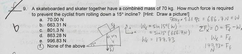

A skateboarder + skateboard has a combined mass of 70 kg.
How much force is required to prevent them from rolling down a 15 degree incline?

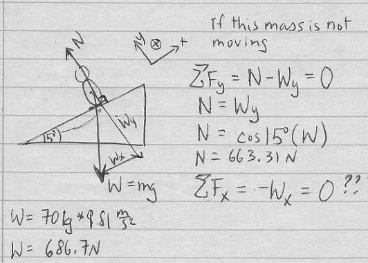

Weight = 70kg * 9.81m/s^2
Normal = cos 15 * W
Friction = sin 15 * W
I solved for friction but my instructor says that I should solve for the Normal force because that is the largest force that must be overcome to get the mass rolling.
I do not understand why exactly since the Normal force isn't a force acting in same direction as the rolling direction.
My instructor said that this isn't just a mass sliding down but that the mass is on wheels so once the Normal force is overcome, the skater will start rolling down.
Am I just mixing up/missing some basic concept?
