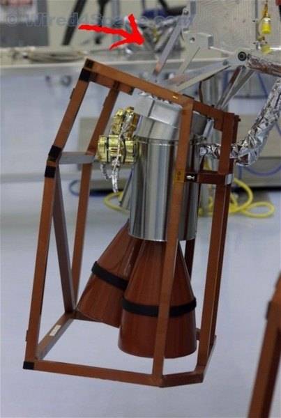

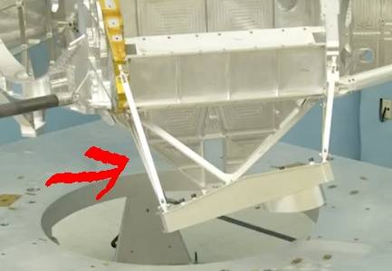

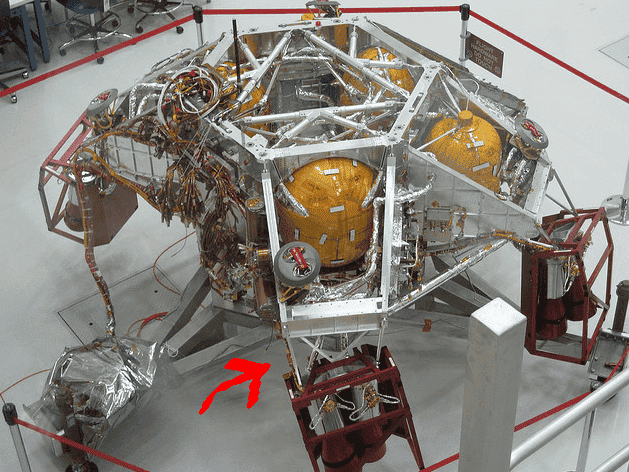

I am not very familiar with systems engineering and have a question about the frame joints connecting the main body of the MSL (Mars Science Laboratory) powered descent stage with its 8 Aerojet MR-80B 800 lbs thrusters (1).
I am not sure what the spacecraft chassis or joints are made of.
The descent stage weighs 2,400 kg with an extra 390 Kg of propellant. The rover itself weighs 900 Kg. This comes out to a total of 3,600 Kg, or 3 1/2 tons (2). Gravity on Mars is 0.38 that of Earth (3). When the powered descent engine starts, the Sky Crane and rover are both plunging towards the Martian surface at breakneck velocity 125 m/s (4).
What type of forces are acting upon these frame joints when the descent vehicle separates from the back shell and the thrusters are at full throttle? Are they solid enough to maintain their structural integrity under such forces?(1) http://matthewwturner.com/uah/IPT20...iles/Payload/Downloads/AIAA-2007-5481-979.pdf

During the decent the primary loads will be thermal. When it activates its rockets the the majority of the loads will be bending and torsion. The second question is kind of silly. That's like asking if a bridge designed to hold people will maintain its structural integrity if people are held. Unless you meant "Are they designed the support the craft when it lands?", in which case I think so.

Actually, those structures look quite similar to how jet engines are attached to aircraft. In particualar, they are designed so there will be NO thermal loads transferred through them as the varioos parts expand and contract. The joints can rotate a bit to compensate for thermal expansion and contraction.

Thank you for your reply. I am not suggesting anything. I am fascinated by the MSL mission and in particular the powered descent stage. I want to understand how it functions and when I looked at the joints connecting the thrusters with the main body I asked myself how they could sustain the forces involved. The joints seem excessively thin. I was trying to figure out how much energy is applied to those joints when the vehicle is airborne and is slowing down, and which type of material is needed to resist the resulting bend and torque from the combined force of the thrusters, vehicle mass, and deceleration.

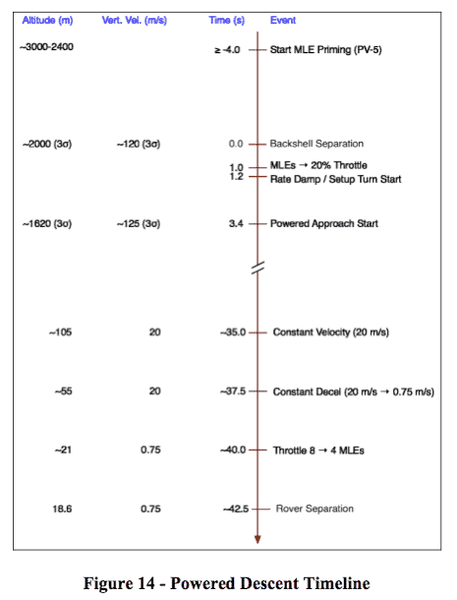

The craft is diving at 125 m / s at 1620 m altitude and slows down to 20 m /s at 105 m altitude.
According to the above diagram the deceleration from 125m/s to 20m/s is achieved in 35.00 -3.40 = 31.60 s and over 1620 - 105 = 1,515 m
