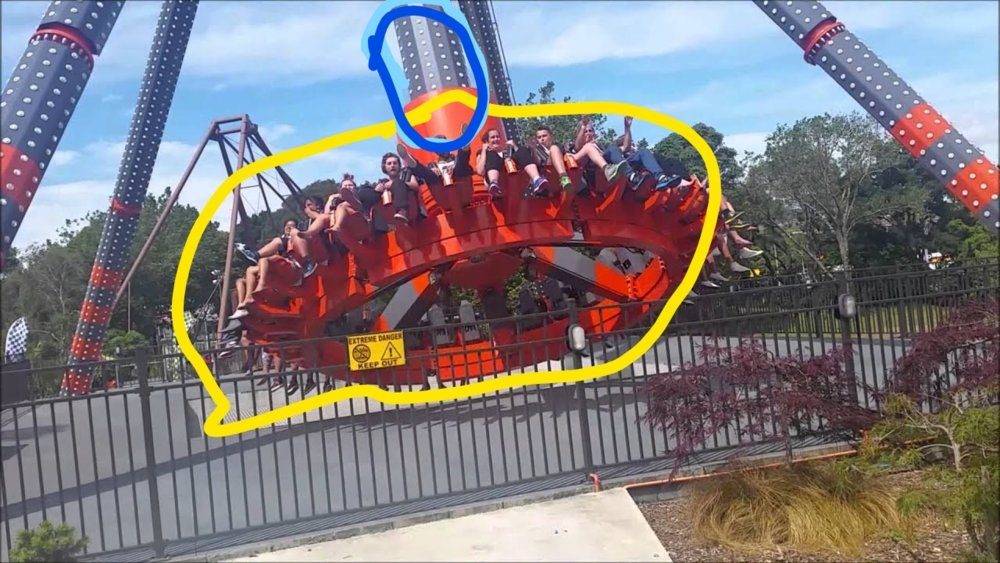

I've been trying to calculate the rotational inertia of this rotating gondola on this ride at this theme park.
However, they do not directly give me a specific formula to use-because with different objects, there are different formulae that you use to determine the rotational inertia of an object
mass of gondola = 6 tonne (6000kg)
radius = 3m
I will attach a picture of what it looks like

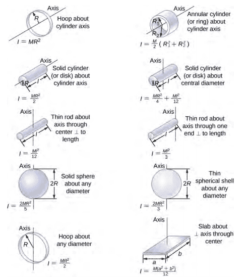

I have attached a picture of different possible formulae's
Picture of gondola:

Formulae:
244603
Initially, I used the equation: I=mr^2
I=(6000)x(3)^2​
T=54,000kgm^2
(but apparently this is incorrect)

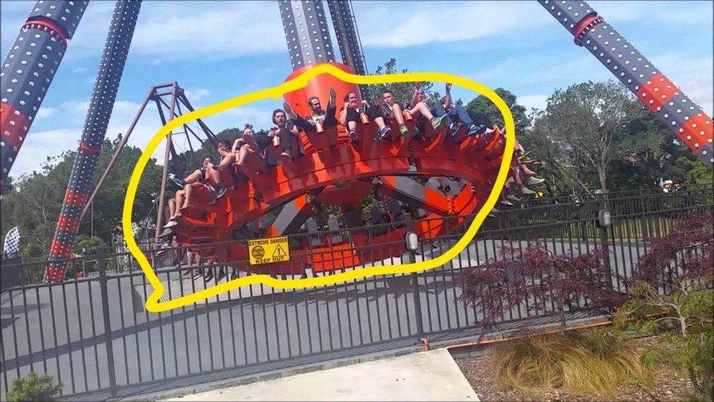

So, basically, I don't know which formula would suit best for the gondola (the picture above). I would consider the gondola a hollow object as the mass is concentrated on the outer edges.

The key question is what axis is it rotating about? I am unfamiliar with this equipment, but it looks like it swings like a pendulum from somewhere up above. If so, you need to know how high that is. You would then apply the "hoop about a diameter" formula, and using the parallel axis theorem add a term mh2 where h is the height of the axis.

Yes, you're assumption/idea of the ride is correct :) (sorry, I should have provided a video)
video: (I believe only the first 10 seconds is enough)
Anyways, if I take into consideration the axis that the gondola is rotating about then that would be the arm/pendulum-tube that the gondola is attached to? (I've circled this part in blue) Is this correct?-I just want some confirmation please.
244611
The length of the pendulum tube is 15m.
Would it be alright to say that the 'height' of the axis (i.e. the pendulum tube) is 15m?

The formulas you posted are all different special cases of the general and always applicable ##I=\int \rho(\vec{r})r^2dV## (and it would be a good exercise to see if you can derive some of them from this general formula).
You'll solve this problem by making a reasonable assumption about what ##\rho## might be, identifying the axis of rotation, and then evaluating the integral.

Yes, that looks about right... except, watching the video to the end I see there is a long section of tube above the axle, possibly with a counterweight on the end. This could easily add 50%; hard to know without more data.
Also I see there is some rotation about the tube axis, but this is small by comparison and does not add to the above since it relates to an orthogonal rotation.
