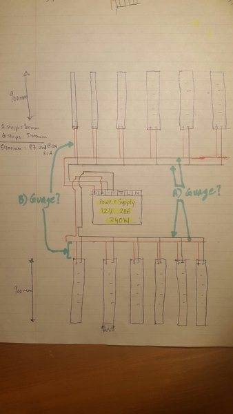

2 sets of 6x LED strips, each 12v 8.1a 97.2W, powered by a single cv 240W PSU, in parallel. The 2 sets are split at the PSU end, each set getting 120W separately. Schematic below,
What I don't know is what gauge wire to use at points A and B? Can you please explain what should be used and why?
I looked at the AWG chart and I don't understand chassis wiring and power transmission wiring. What category do my wires fall under?
Also, I haven't figured out yet how long exactly will my wires be at point A and B. I know length of the wire has some effect on the gauges, but don't know what effect. Can anybody please present a general guideline or pattern describing what happens as I increase or decrease my wire length?
Much appreciated!

For what you are doing it would be considered chassis wiring. Power transmission wiring usually refers to the aluminum, or aluminum/copper clad wires used for high voltage transmission lines. I don't know what they are referring to in the above chart.

For 8.1 amps, 16 AWG copper covers all the bases, but for short runs in open air at room temperature you can get away with wire as small as 20 AWG.
For each set of (6) 8.1A light bars, the wires to the power supply carry 48.6 amps.
What I don't understand is how a 20A, 240W power supply will work with 16 light bars at 8.1 amps each (1166W).
Likes berkeman and Sam_A
What would you recommend for my setup? How short exactly is a short run?
To give some dimensions, the (A) 8.1a wire(s) will be 6-10 feet each, and the (B) 1.35a wires will be 10-15cm.
The ambient temperature I don't expect to rise past 40C. Mostly, I expect it in the 25-32C range.
Oh, I misunderstood.
If each light bar is 1.35A, their 10 to 15 cm runs can be 24 AWG.
16 AWG is still a good choice for 6 to 10 foot runs of the (A) wires.
