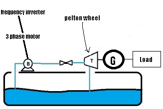

Ok, So I'm bulding a prototype of a hydropower plant, that will be used to teach kids.
I have NO CLUE about what generator to use.
So here's how it works (check the attached pic):
- We have a water tank
- A pump pulls the water from the tank
- the water is used in a pelton wheel
- a generator will use the turbine rotation to create eletricity
- there will eletric loads after the generator
Ok, so our teacher told us to keep the turbine rotation at 60Hz and H=2 bar. It's going to be a self controlled system.
The kids are going to play with the loads -> let's say they increase the load, so the turbine will slow down
the valve is going to open to take the turbine rotation back to 60Hz (motor controlled valve)
as the flow increases, H decreases
then the frequency inverter is going to increase the frequency of the 3 phase motor of the pump, so it goes back to the original pressure (H=2 bar)
(check this http://bit.ly/1YsqKpr )
With the turbine rotating at 60Hz, will the generator too?
Well, I don't even know what to ask... Help me out please
Thanks in advance

Neat project. On a previous thread there were some very helpful YouTube videos. I'll try to find them for you tomorrow.
It is likely that you will want some pulleys and belts so that the generator shaft speed does not need to match the turbine shaft speed.
How much vertical head (water height) do you have? I ask because Pelton wheels need higher pressures than other types of turbines. You say 2 bars, that is roughly 20 meters of head.
Your narrative about 60 hertz and inverter and three phase motor sounds jumbled. What kind of generator will you have AC? DC? How much power must you generate? How much water flow do you have?
Likes HueHue and jim hardy

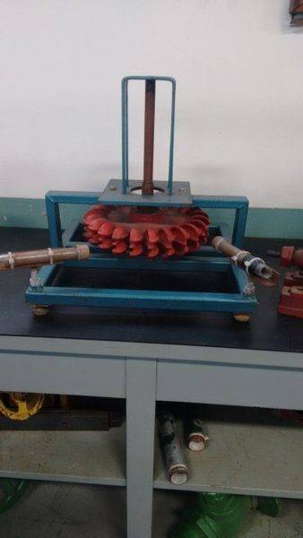

Well, I'll be using a water pump to pull water from a water tank. I can work with the pressure. Btw, the pelton turbine I have is small (check attached pic).
Yes, what I said about keeping the pelton wheel in 60 Hz doesn't make sense, because it's rotation depends on how much rotation I need on the generator.

About the generator.. Well, I couldn't find a small generator/alternator so I'll probably use an inverted 3 phase motor as generator (not sure yet). I don't need much power, I think I'll be lighting a few light bulbs as a load.

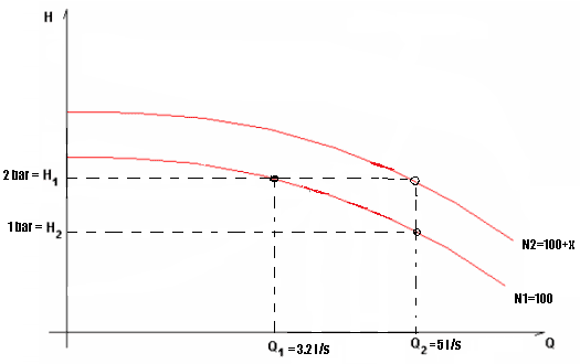

I'll work it with water pump as well. I have no clue about the volume of the water tank yet.Just to clarify what I said before about the inverter and the 3 phase motor of the water pump...
Let's say we are working with a flow of 3.2l/s, pressure of 2 bar, and that this outputs 60Hz on the generator.
Then someone lights more light bulbs.
By doing so, the frequency on the generator is going to go down a bit, let's say it goes down to 50Hz.
Then I'll open the valve a bit to increase water flow (lets say it goes to 5l/s), making the turbine go faster, and thus making the generator output 60Hz again. Ok.
But by increasing the flow, the pressure is going to go down a bit. Let's say it goes down to 1 bar.
The pressure must be kept at 2 bar (proper simulation of a waterfall (constant height, constant pressure)).
To fix the pressure, I'll increase the frequency on the 3 phase motor of the pump, with the frequency inverter.
Q: water flow , N: frequency of the 3 phase motor of the pump , H: pressure
Q1= 3.2l/s , Q2= 5l/s , H1= 2 bar , H2= 1 bar
Let's say we had N1= 100Hz
By increasing N, we can change the point of operation of the pump.
So by increasing N we can increase the pressure (taking it back to 2 bar), without changing the flow.
Check the other picture :)Thanks a lot for your help!
